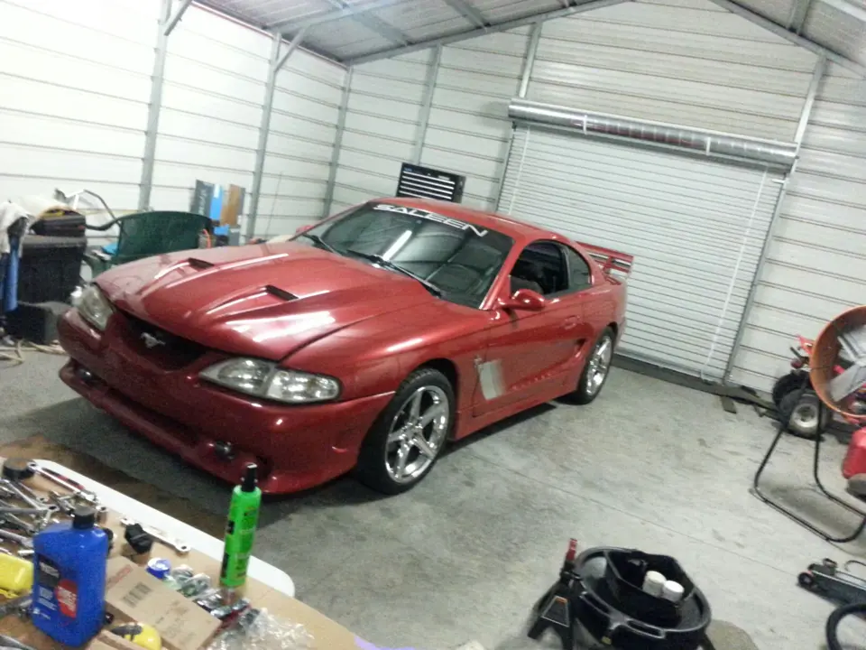

thanks to all that replied. Yeah I have a cervini's hood, will post a pic. And from the sound of it, it won't hurt to try the stocker :)
If you like the hood, keep it but plug the ram air opening so that it doesn't allow air into the engine bay.
Do this if and only if, you notice cooling issues while the car is moving.
I thought that would allow or keep the bay cooler?
also no apparent issues with car moving with current radiator
Introducing additional air BEHIND the radiator is not a good thing if it's not been pulled through it. Ram air hoods effectively reduce the air that must pass through the rad. It's not always a problem. Lots of times, that flow change is made up for by under car air. Lots of other things can effect it too.
oh ok
