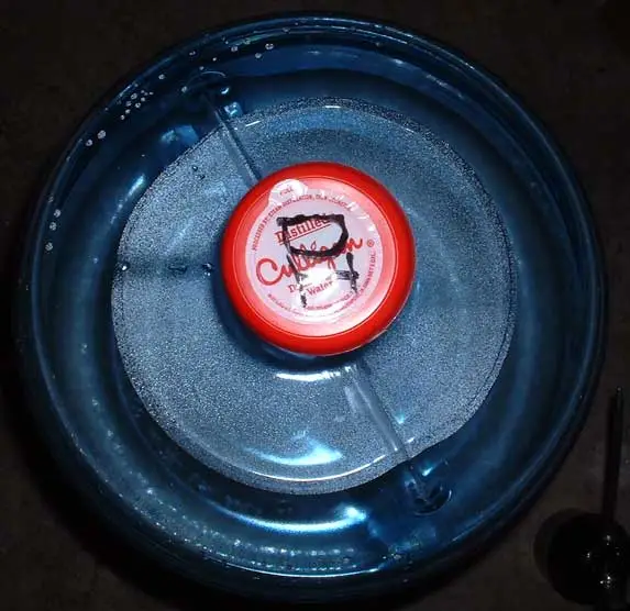

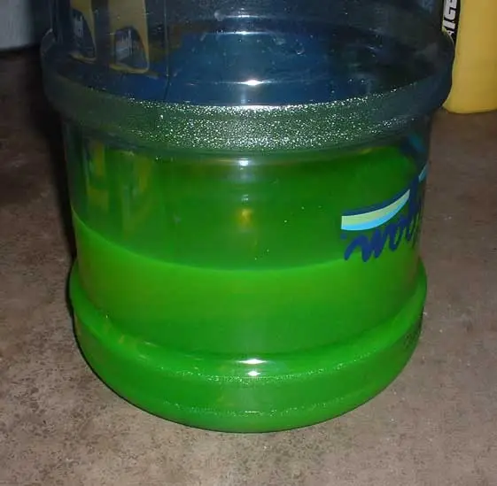

I also suggest getting de-ionized water. This is what AFR suggests to use with the aluminum heads. De-ionized is not simply distilled. I went to Culligan and got a 5 gal "water cooler" style jug for about $6.00 (plus bottle deposit). Make sure you get de-ionized and not just distilled, as I had to return because I didn't get the right stuff the first time. My local Culligan writes "DI" on the cap...
You can then use the jug to mix the coolant/water. Get 6 gal antifreeze. Remove 3 of the 5 gals (into a clean container(s)), and pour in 3 gal antifreeze, and you got 5 gals of 60%/40%. Empty the mix into 1 gal jugs, pour 2 gals of DI in, another 3 gal antifreeze, you got another 5 gal coolant. Plenty for a few fills...
