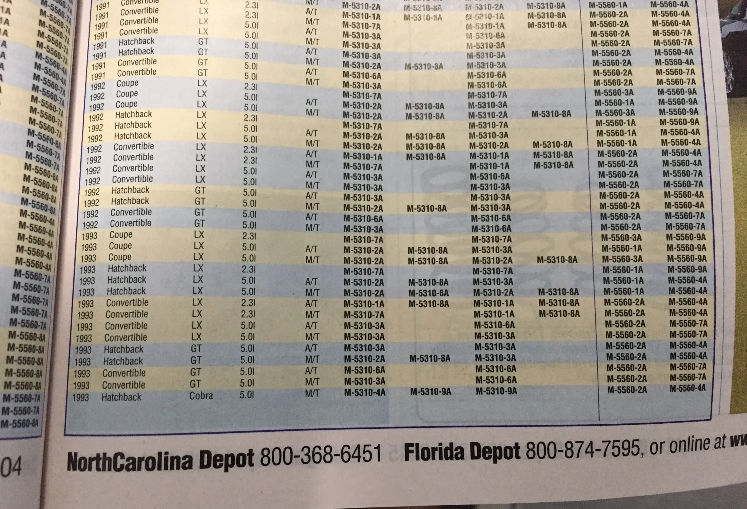

Here's a pic of breakdown of 1993 models and which springs are used. They are $99/pair. I'd imagine online would give you more clarity than my pic

National parts depot has a good selection depending on what model and if your car is stick or auto or has A
Edit:
The pick looks plenty clear. Thanks for posting it.

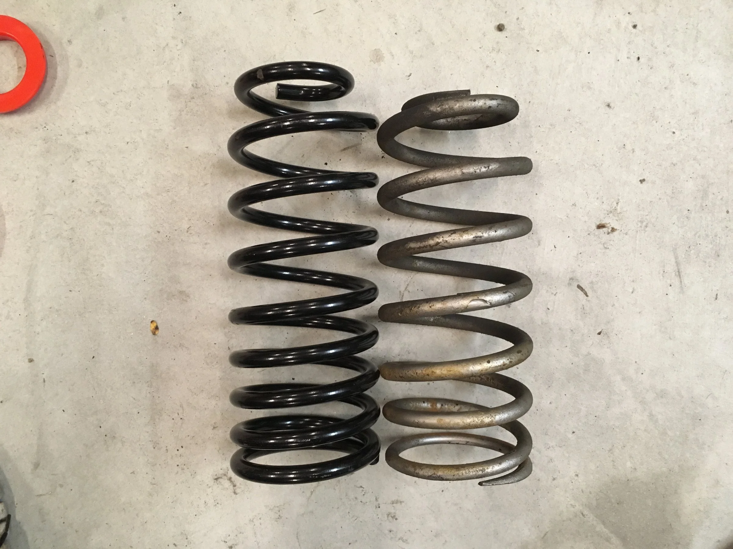

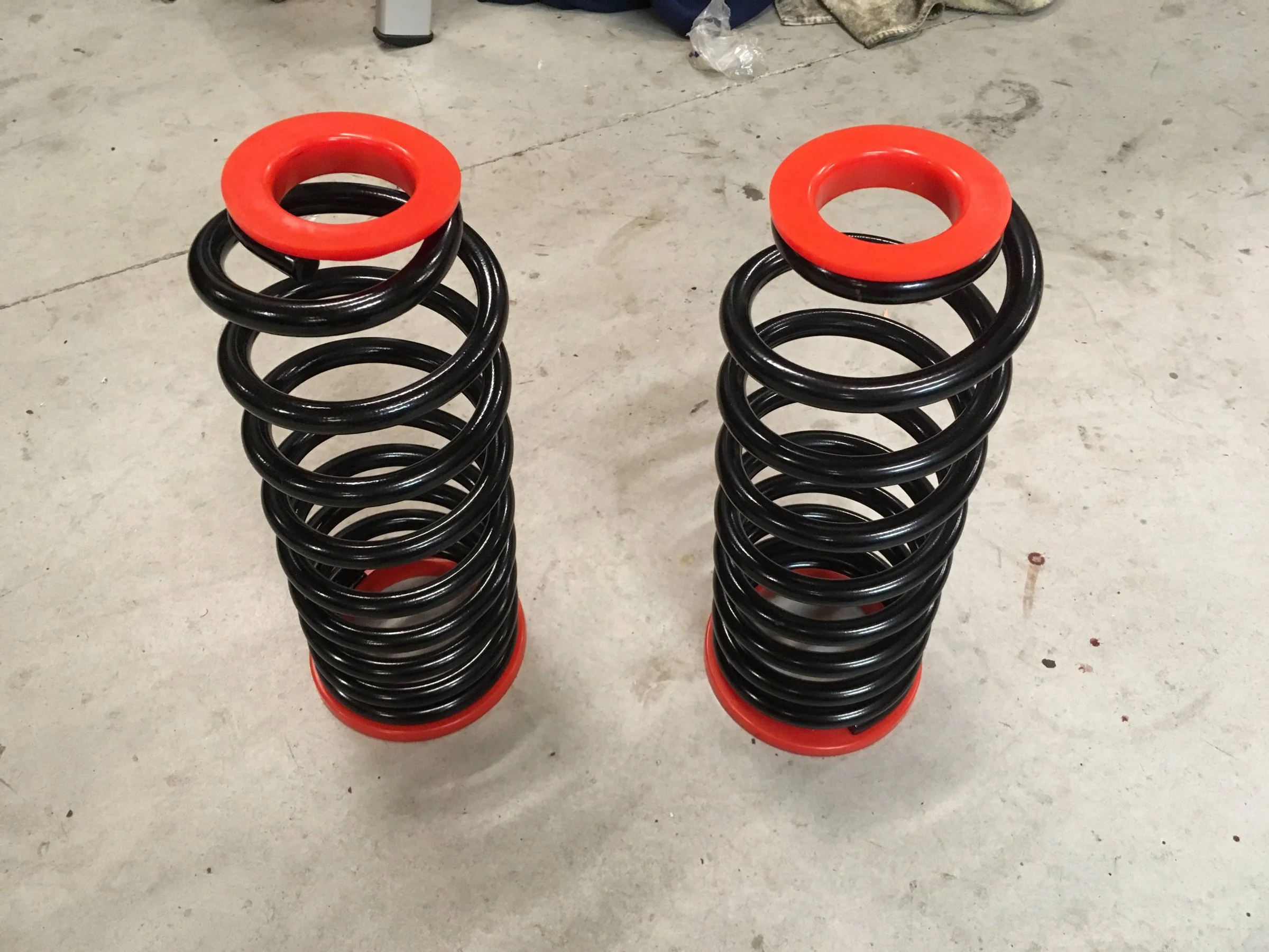

Here’s the stock height progressives before installation. Going in now. Got stock front springs already in. I took a before photo of the car stance and I’ll take an after and post them together when the rear spring swap is done. These progressives were $39 from Autozone ship to home. Got the isolaters off eBay

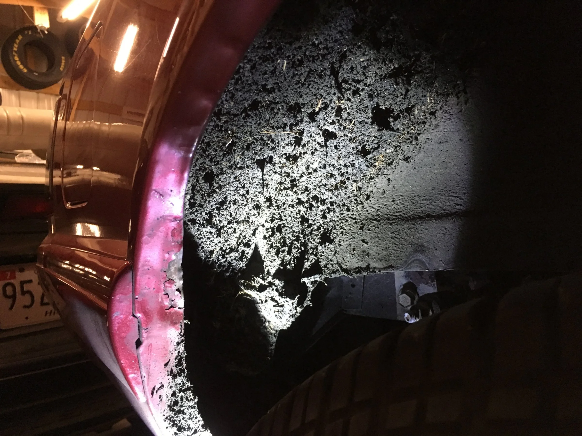

This thing came into our possession with a story of turbo race car history. The rear wheel wells have extra gear head undercoating. Caked on about 1/2” thick.

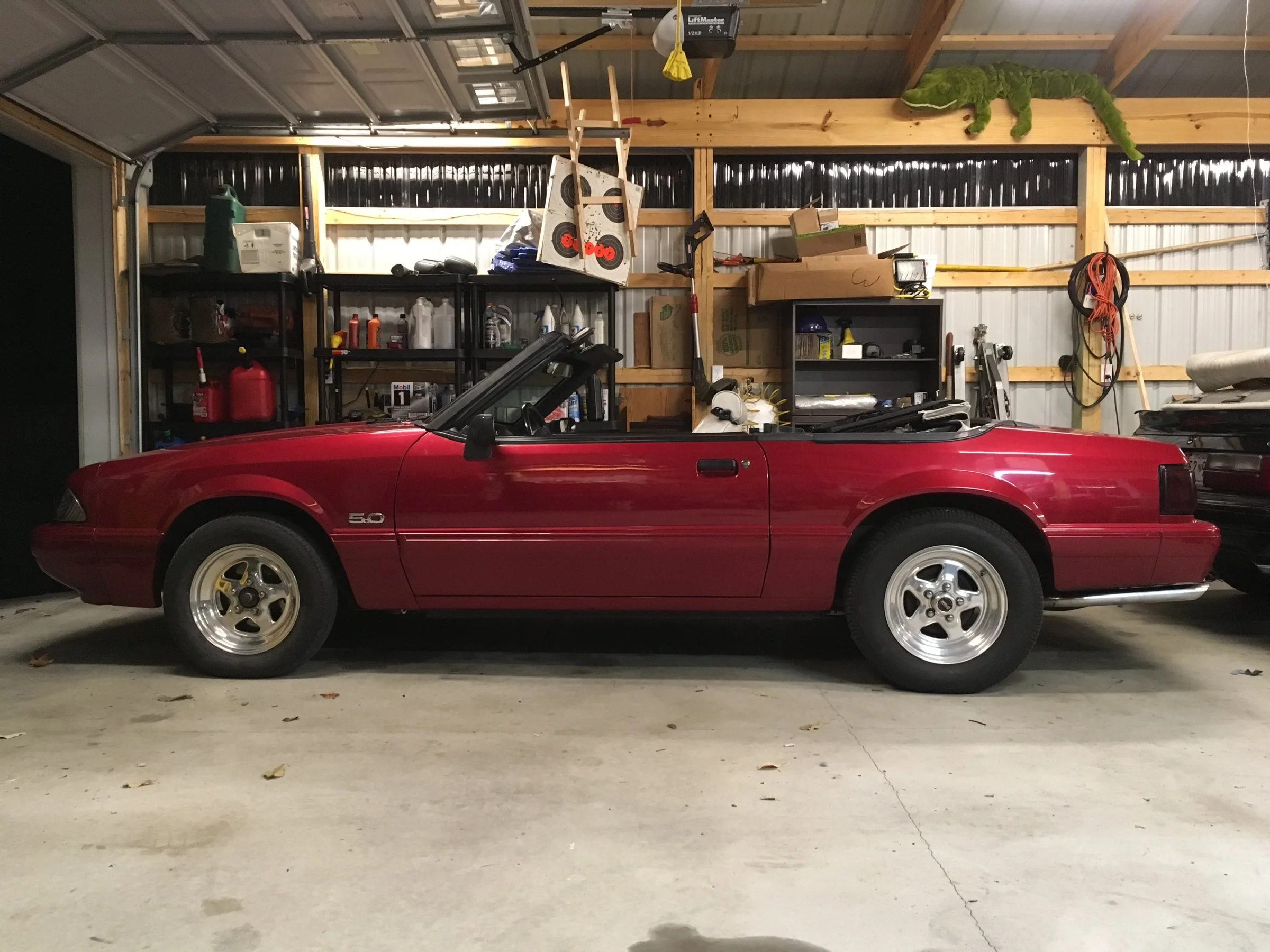

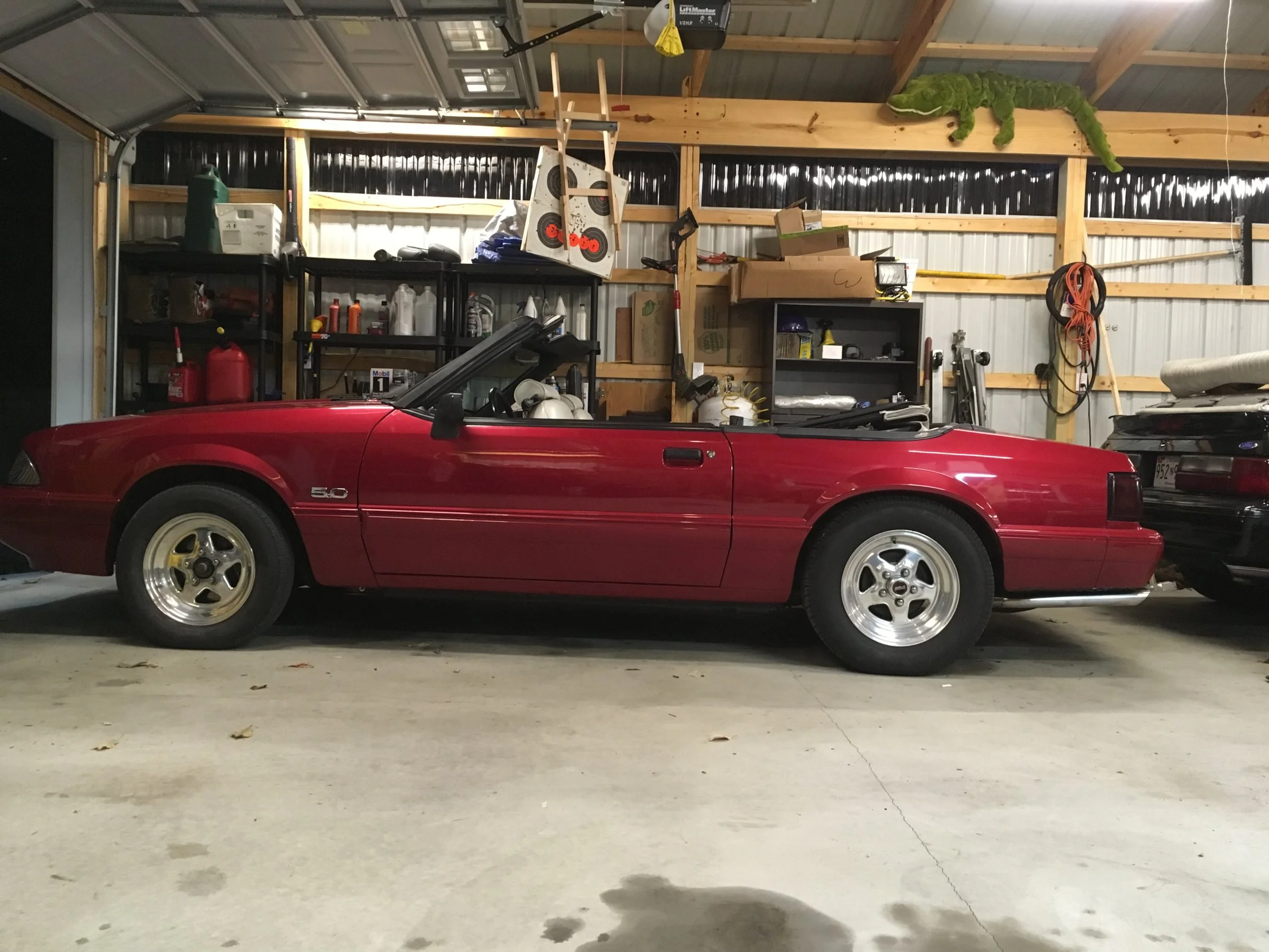

Before and after. For sale is a set of Foxbody 1.5” drop springs (front and rear) and Southside traction lift control arms and brackets. Also Strange adjustable rear shocks. $250 takes it all
