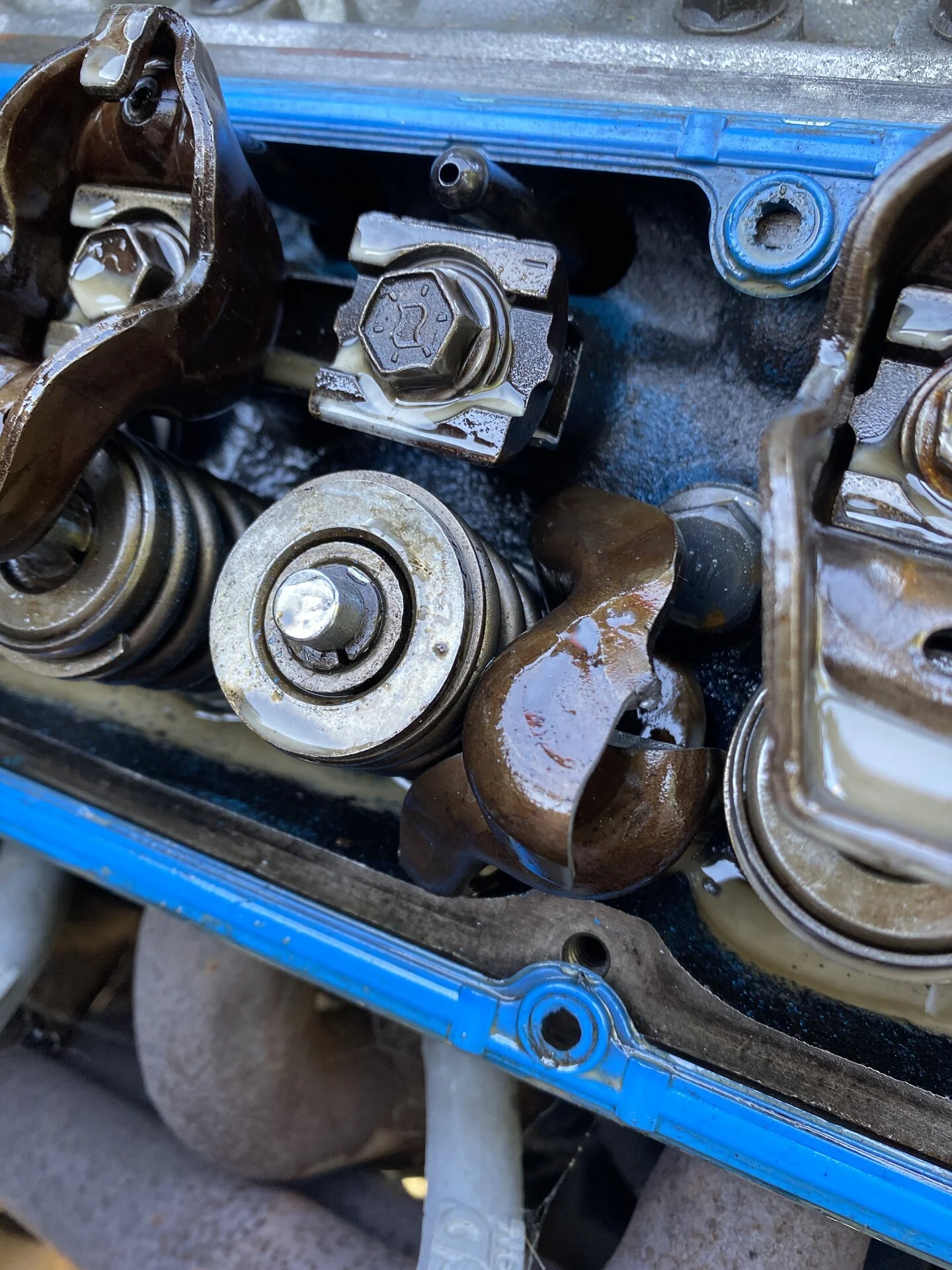

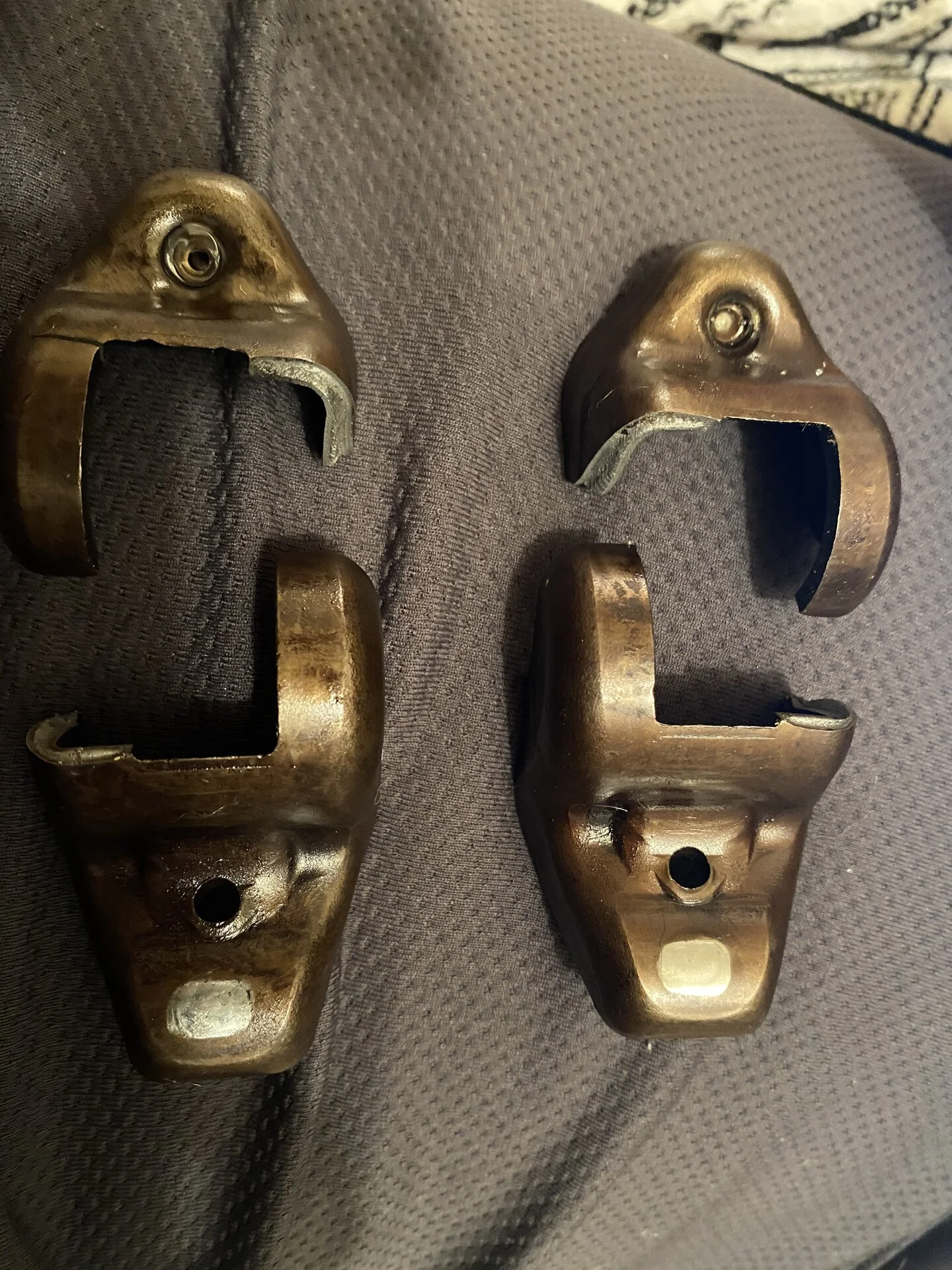

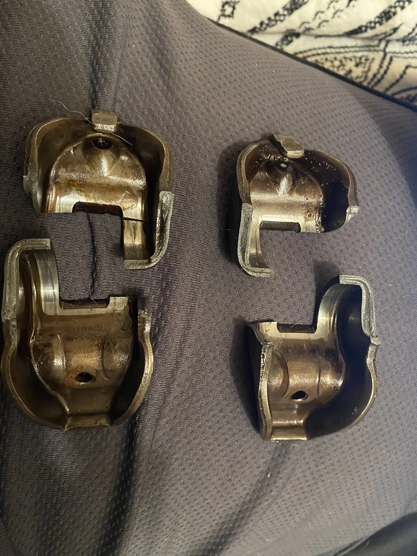

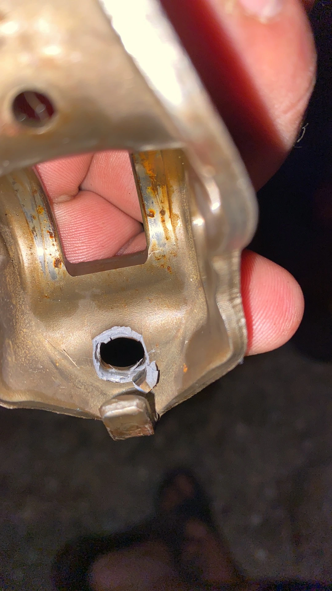

So i currently have a 93 lx 5.0 mustang with keith black 116 domed pistons, a Lunati Voodoo .571/.587 lift .282/.290 duration and a 110 degree lobe separation cam, now i have the stock junk E7 heads which have been ported and this is supposed to be a budget build and later on it will have a set of blue print muscle car series heads on it, also has a weiand 8020 intake with a holley 650dbl pump carb and long tubes....i installed the cam used stock push rods and rocker arms....bent a few sets of the push rods, so i ordered chromoly comp cam push rods, because JEGS said it was necessary (all the push rods from stock to the chromoly ones are all 6.248'' stock length) I installed those today, torqued it down, fired it up and boom broke 2 rocker arms one of which was in two pieces and one of them the push rod went through where the rocker arm rests on it, replaced them with stock ones again because my thought was they were hurt from the previous push rods bending, then broke 2 more....the weirdest thing is its only on the intake side and only on cylinders 1-4 nothing is wrong with cylinders 5-8, so i again thought well it must of broke the other 2 that was weak....first start was cylinders 2 and 4 second start was cylinder 1 and 3, a close friend of mine said the stock rockers dont move far enough for that big of a cam, another friend said the cam is to big.....any help would be much appreciated! and THANK YOU IN ADVANCE!!!!
Coil bind dude...When you are bending and breaking stuff something is hitting things.Springs stacking, or valves hitting,..both are bad.

You checked ptv clearance and all good, next step should be checking push rod length, actually that should have been done before.
Now I see a mark on top of the valve stem, I also see a mark on the cap thing next to the valve stem, that tells me there is a fitment problem, like the rocker arm in hitting it, I'm not a engine builder but you are wasting your time and money with those E7 heads.

So the issue I had was I was using bone stock pedestal mount rocker arms, so the issue was the slot wasn’t made for a cam with much more then .520 lift so having a cam that has .571/.587 lift was just complete destruction so with that being said the cam was matched to the intake and the heads that is going on the car later, so in all honest simple mistake by not knowing much about the stock rocker arms lol could of cost me a lot more then it did and I am so thankful for the help and advice given here.... I understand how bull headed people can be and it’s bs when someone gives good advice and the person asking for advice spits in their face...people like that need smacked! I’ve also put a x303 cam in with bone stock rocker arms...not sure how that motor is now that it’s been sold for 3 years and I didn’t know then what I do now lol.
Reactions: Wayne Waldrep
So the issue I had was I was using bone stock pedestal mount rocker arms, so the issue was the slot wasn’t made for a cam with much more then .520 lift so having a cam that has .571/.587 lift was just complete destruction so with that being said the cam was matched to the intake and the heads that is going on the car later, so in all honest simple mistake by not knowing much about the stock rocker arms lol could of cost me a lot more then it did and I am so thankful for the help and advice given here.... I understand how bull headed people can be and it’s bs when someone gives good advice and the person asking for advice spits in their face...people like that need smacked! I’ve also put a x303 cam in with bone stock rocker arms...not sure how that motor is now that it’s been sold for 3 years and I didn’t know then what I do now lol. Also I forgot to mention that the slot was catching on the fulcrum and that’s why it was breaking rocker arms but not damaging anything else and bent the stock push rods...which honestly idk what lift the stock push rods are good for.
