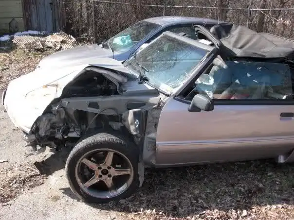

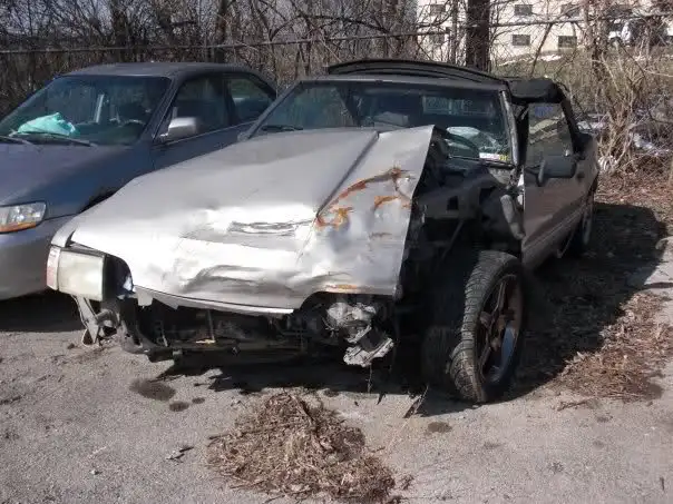

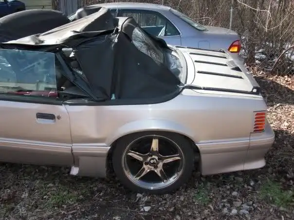

So very long story short, a drunk driver creamed my 90 GT vert, the body is a loss but the motor is fine. I'm in the market for another Fox, and when I find it I'm going to stuff either a 331 or 347 (more than likely 331) shortblock built by FordStrokers.com into it.
