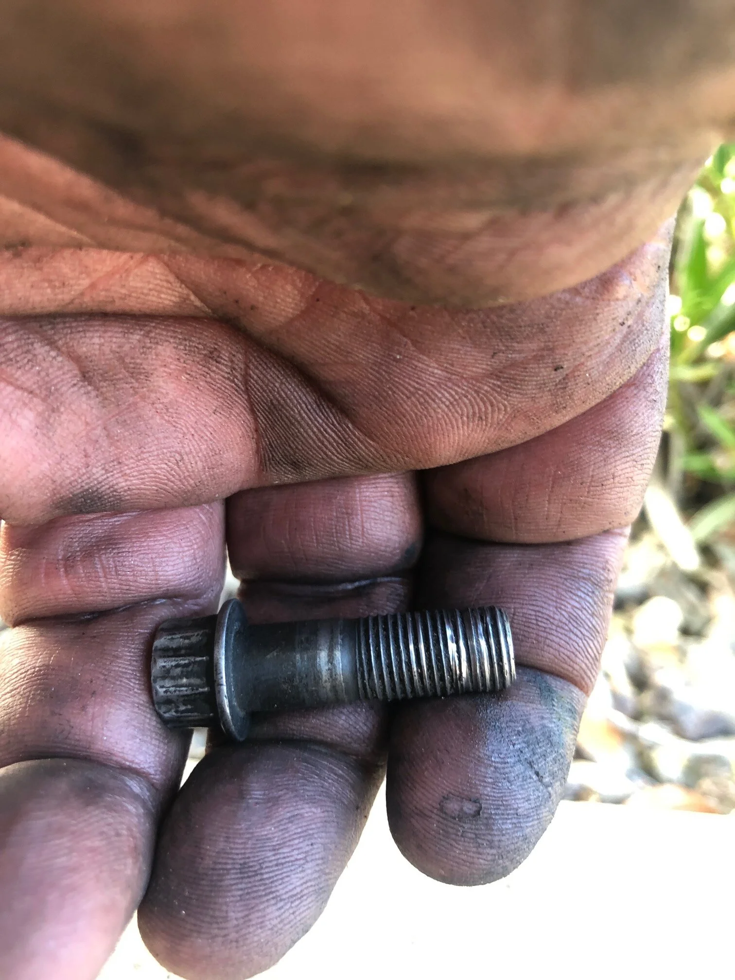

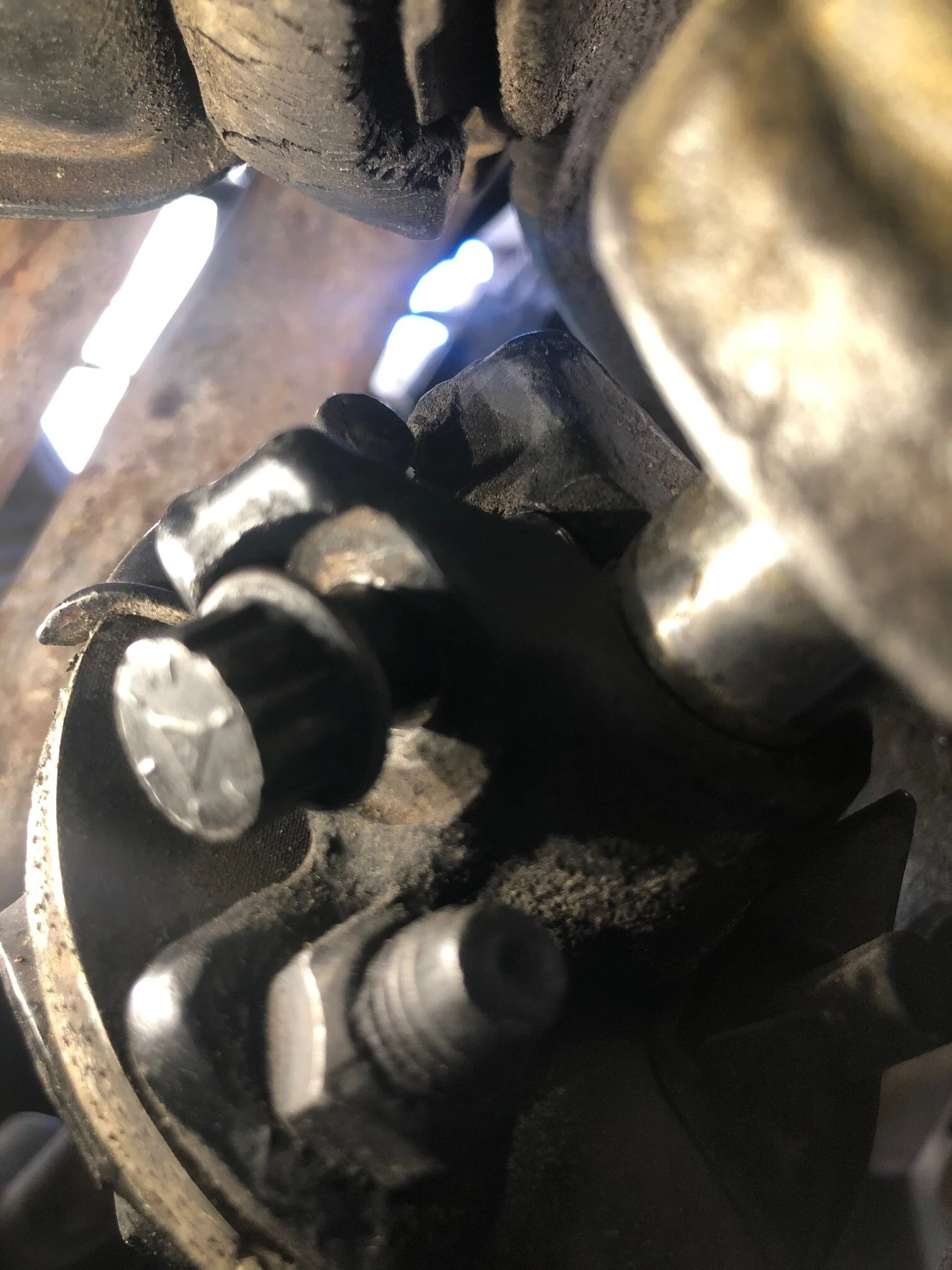

Once again thank you all for the advised and assistance with this project. I have com again to ask you for you advised once more. In the past step I am having an issue with the pinion screw. It is not going back in. I am thinking about getting a c clamp but there is no space. Does nay boys have any suggestions?

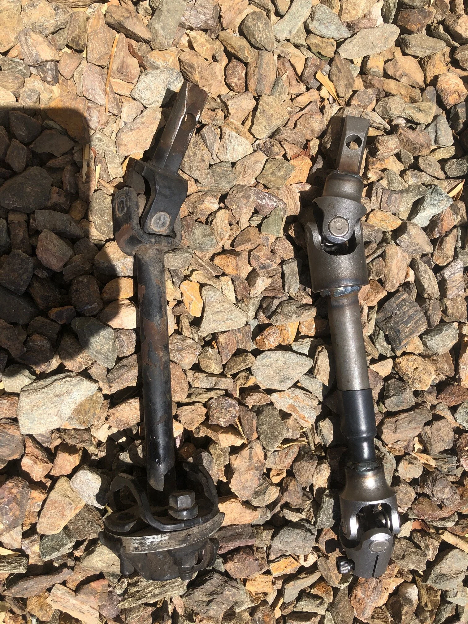

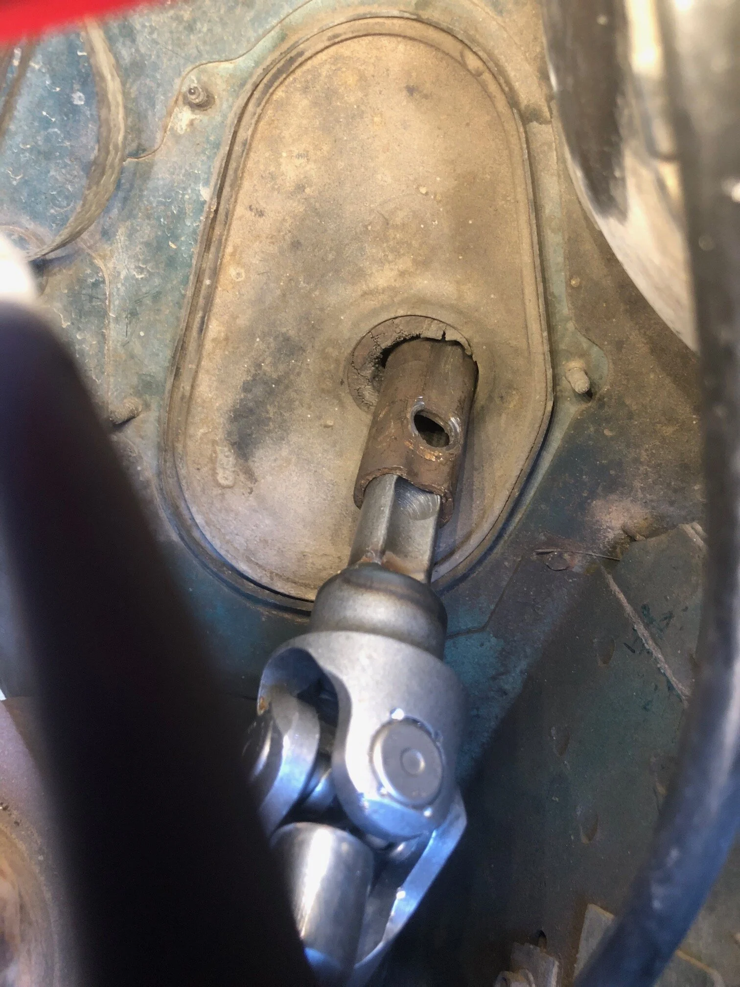

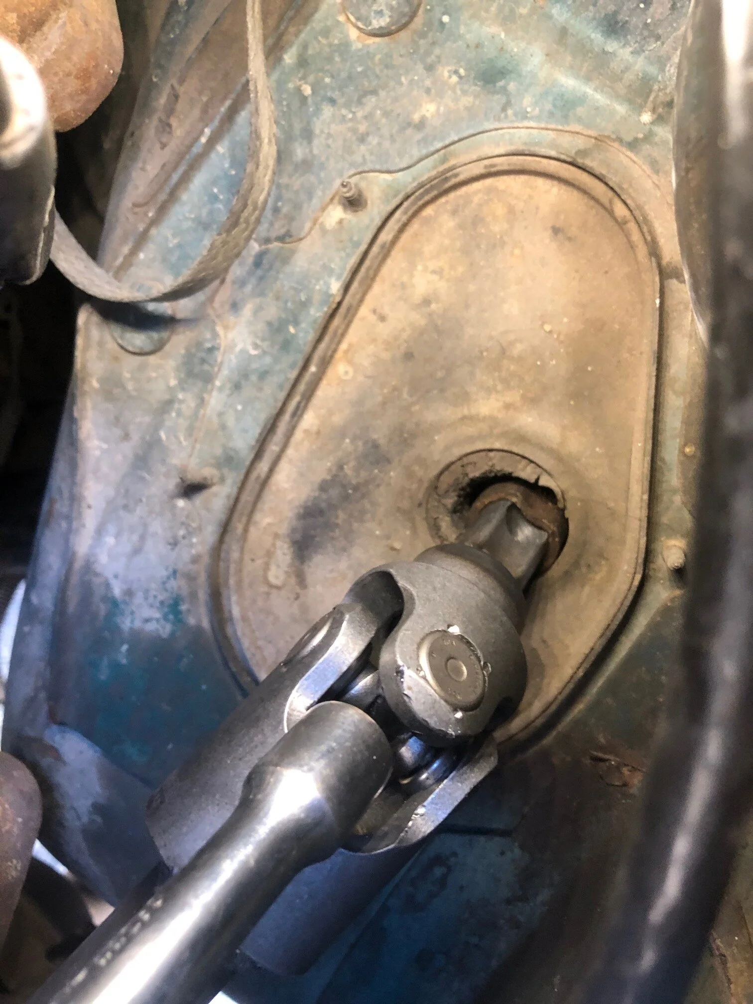

Once again I ma in need of your expertise. I got Maximum Motorsport power steering shaft. I removed the old one.
However, it is not going in.
The instructions said that tapping the top part of the shaft in order to push the shaft into the column may be needed. I have done that but now I got the steering column completely collapse.
Have anybody else ran into a situation like mine?? Any suggestions?? I got a wild idea to put the MM shaft in the freezer and try again later. Current temp in Phoenix Az is 111F. Remember it's a dry heat folks . Thanks again.
Yup. I ran into a same issue like that. I think I had to put a screwdriver in it and open it up a bit. When you bolt it down it will suck that all down again.
As for pulling the shaft on. Put a peice of wire on it and then use a weight like a slide hammer to impact it out
