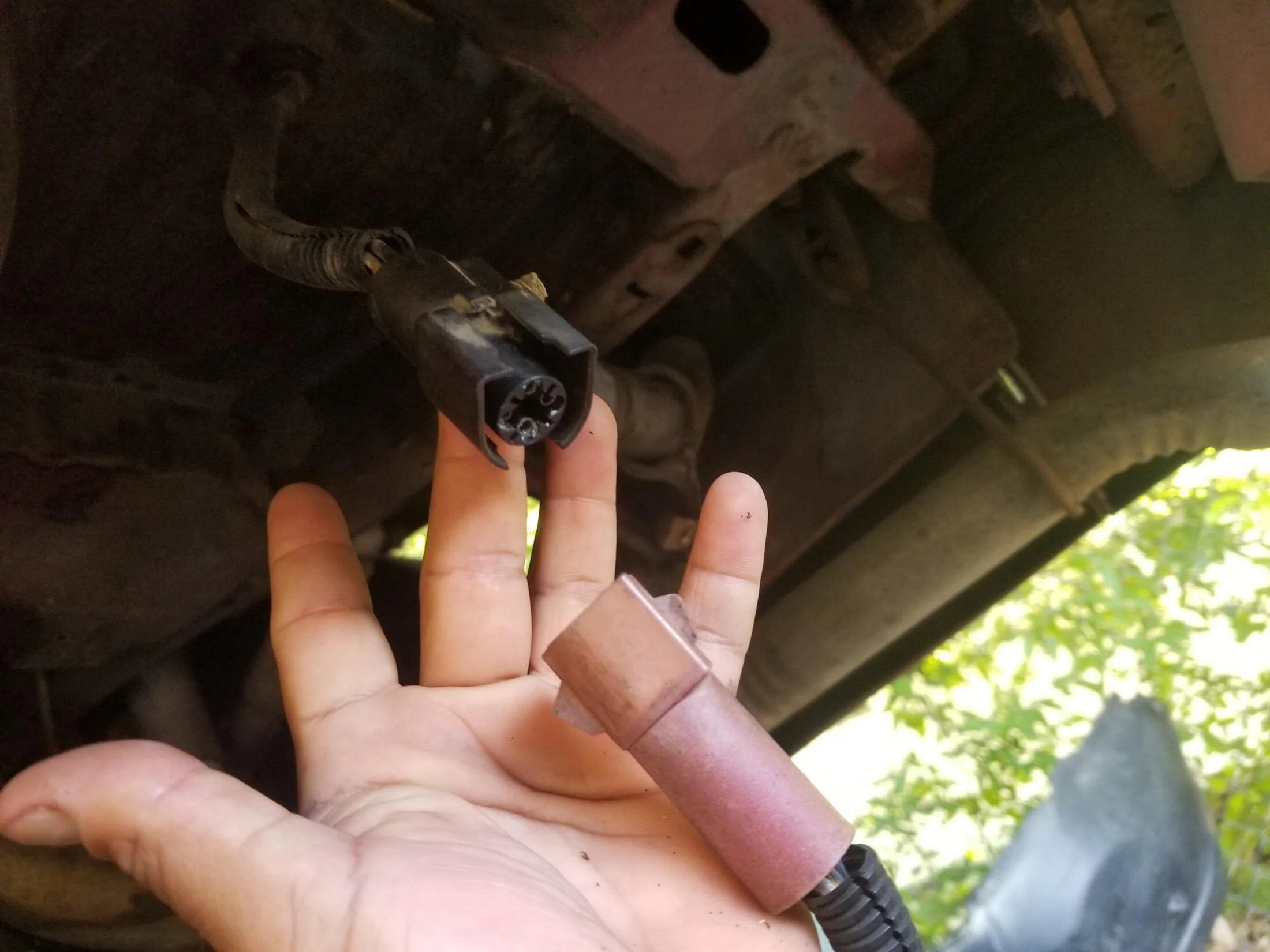

You can back probe the wire in the connector behind the rear bumper, under the car, and just above the fuel tank.
This is the connector pulled apart:
You can see in the very upper center of this picture:
My guess is the fuel pump wire colors will be pink/black for positive and black for ground.
