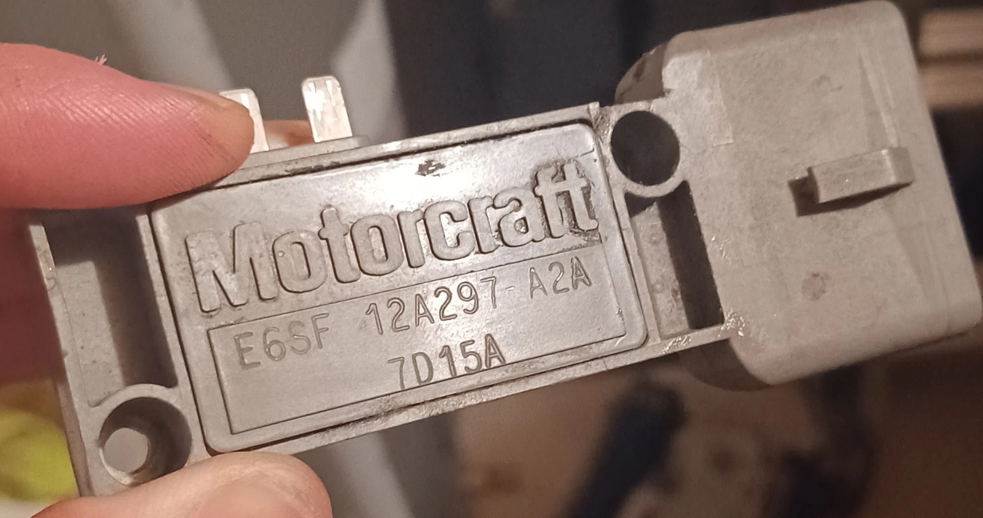

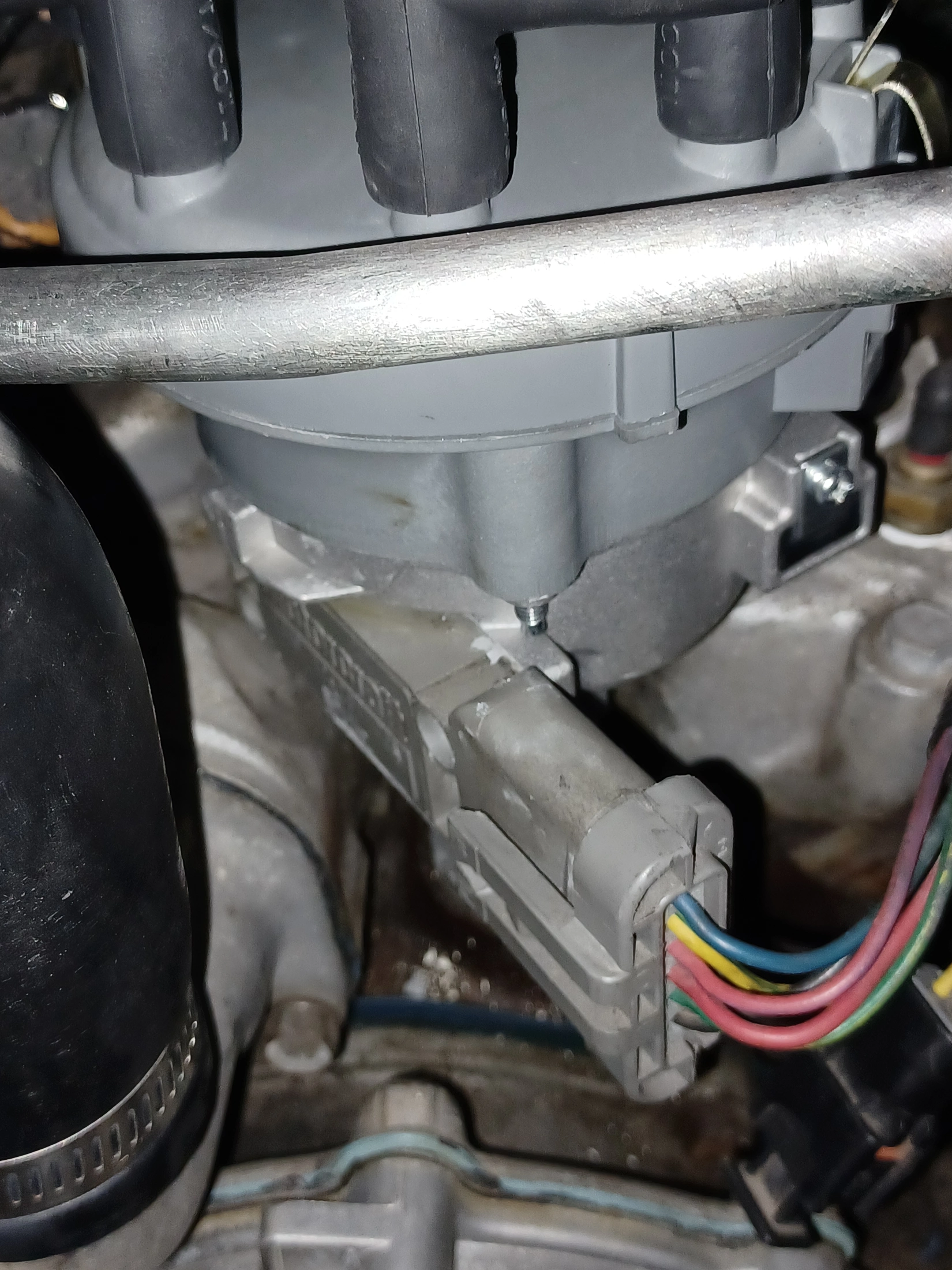

Everyone, I ran a quick experiment regarding the distributor, and so far it has fixed my issue.
I was going to put my original Ford factory distributor back in the engine.
But I wanted to try something first and im glad I did.
I kept the new aftermarket (LMR) distributor in the engine and removed the TFI module that came with it. I placed my original Motorcraft Ford factory TFI module on the distributor. ( added a good amount of thermal paste on the back of the TFI too)
I started it up and took it for a drive.
So far, I've had no stumbling, misses or engine hesitation like before. It runs great even while cruising at the low to mid-range RPMs (where most the stumbling would occur).
1. I think the PIP sensor in the original ford factory distributor was going bad or is bad?
OR
2. The TFI module that came with the new LMR distributor is defective?
(Which I have read that these aftermarket TFI modules are not great; even though they say the modules are infact current Motorcraft TFI modules. I think the build quality is not up to par with factory original TFI modules).
Overall, I think this may have fixed my problem and I want to thank everyone who has chimed in to help me on this issue.

Car is fixed. It was the distributor TFI module or the worn out PIP sensor on the original distributor. Also, the TPS can be set at a range of 0.72. It doesn't have to be 0.97 to 0.98 volts. That's a myth and my car runs fine at its current tps volt range. As long as the volts are below 1 volt at idle and they steady increase to an approximate 5 volts at wide open throttle.
I've also done a base idle reset in the past but it did not perform well because the distributor turned out to be the issue.
