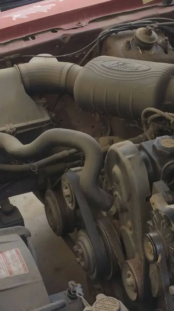

So I noticed the other day when trying to figure out why my car isn't passing smog (gotta love Cali) that the upper radiator hose dosent look right.
It actually comes up higher than the radiator before dropping back down. I'm trying to confirm that's wrong. On a side note I'm pretty sure I need to replace my thermostat seeing as how the car never gets hot unless at a dead stop for like 35 min.

Your right on both counts.. Air rises in the (closed) cooling system and if it can't get to the cap the system can't eliminate it. The cap, which moves hot coolant to the overflow bottle when it expands and returns it to the radiator when it cools and contracts, needs to be the highest point in the system.
Sounds like the thermostat is stuck in the open position (or non-existent) which is rare but I guess it happens. Change the oil while your at it because long heat up periods allow condensation on the cylinder walls to drop to the oil pan, not to mention uneven warm up on moving parts and forever to use the heater... :)

The hose is just the complete wrong shape for the car. Spark plugs to me seem to be personal preference. I've tried almost all of them and gotten pretty much the same result.
