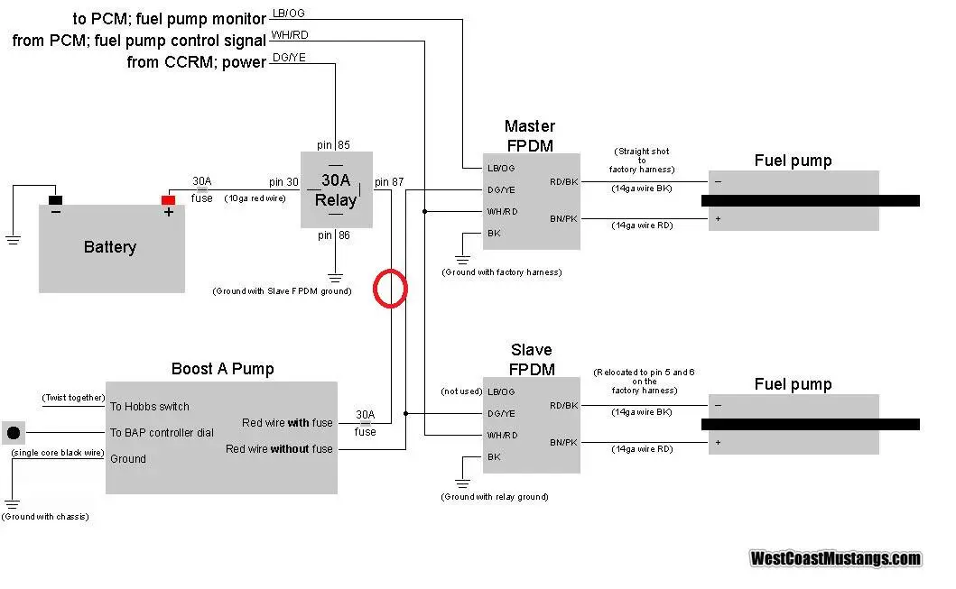

Fuel: 2 Ford GT pumps lined to two FPDM supplied by BAP with the wire upgrade.

Drove it to work one day and the car died on me. Found one of the connectors going from the relay to the BAP burned up. Replaced the connector and drove it home. The next day I realized I couldn't go WOT past 4000 rpm without it stuttering and backfiring.
Attempts to fix so far:

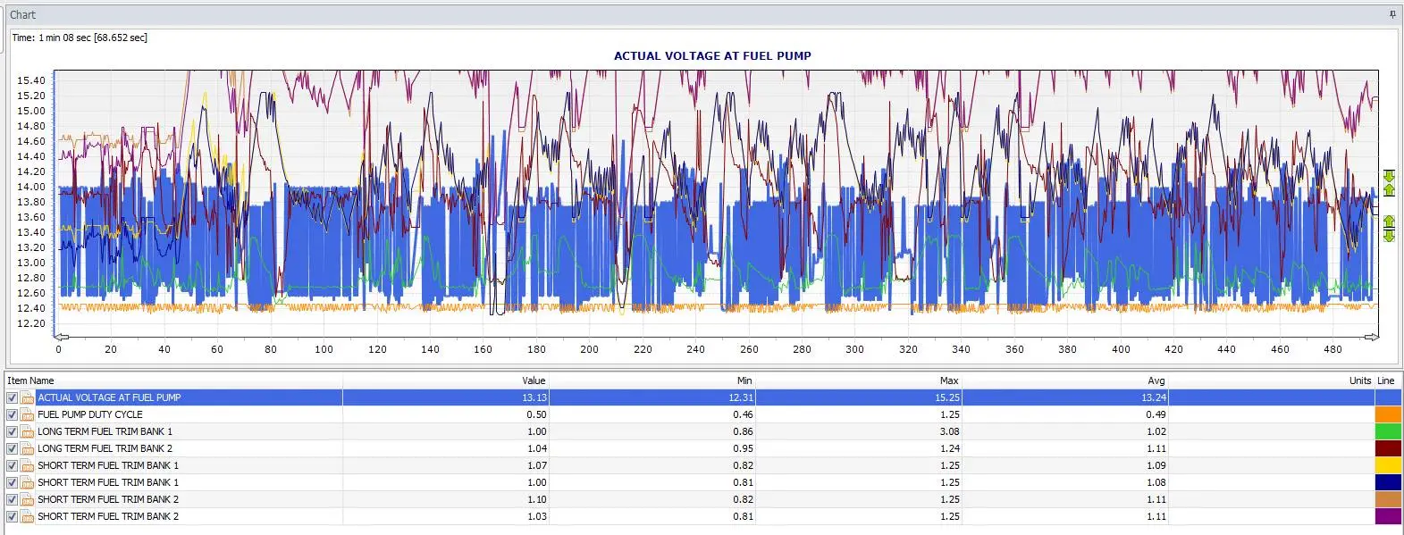

Cleaned MAF and Air filter, replaced Fuel filter, checked voltages on BAP(17+ volts), checked voltages to fuel pumps(17+ volts).

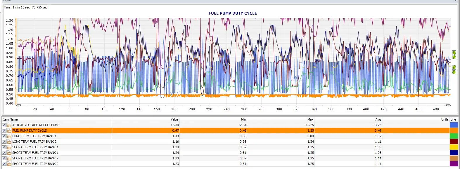

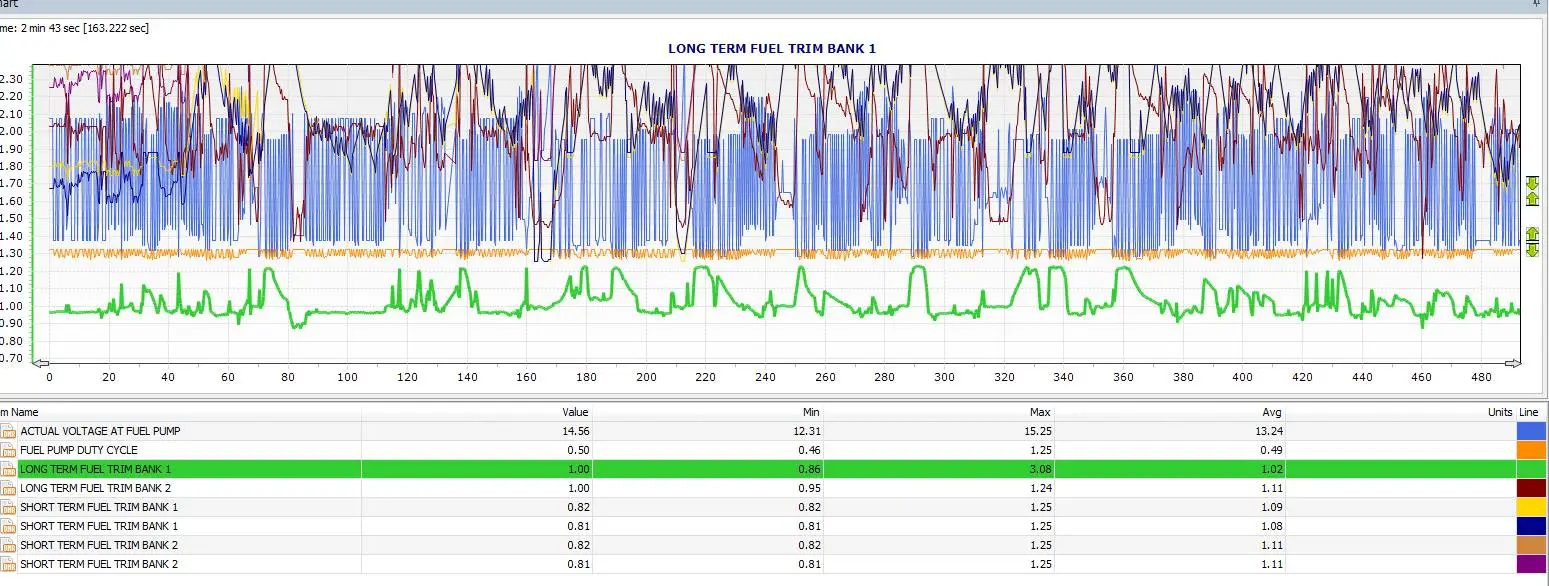

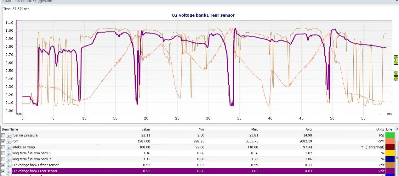

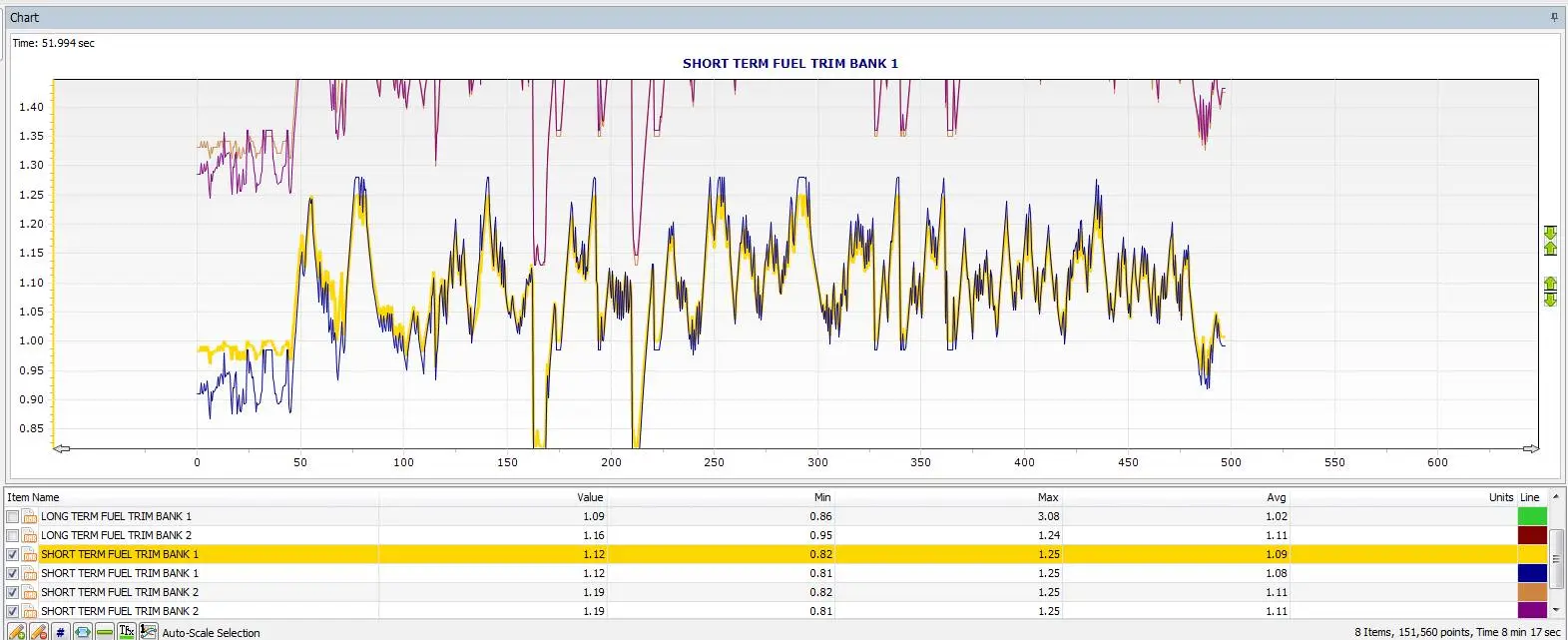

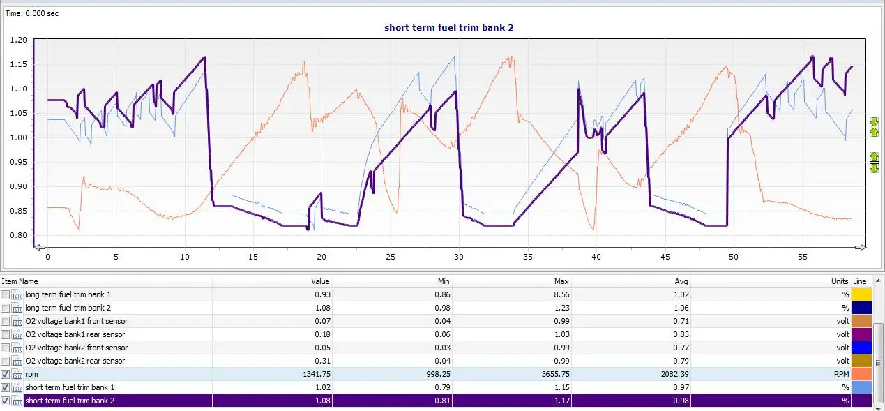

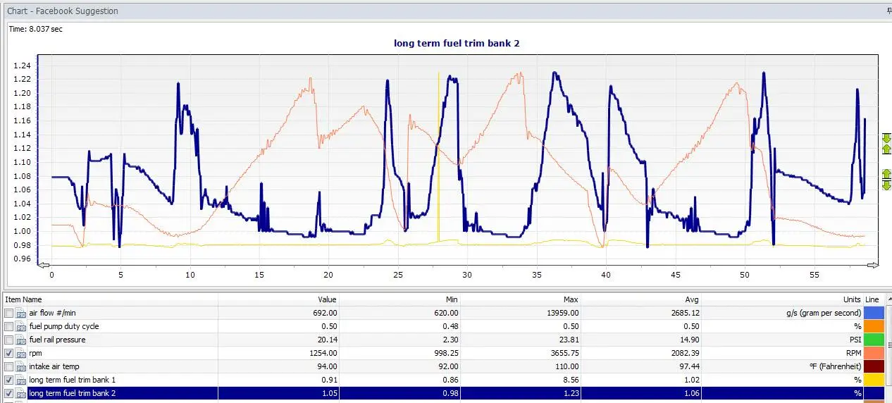

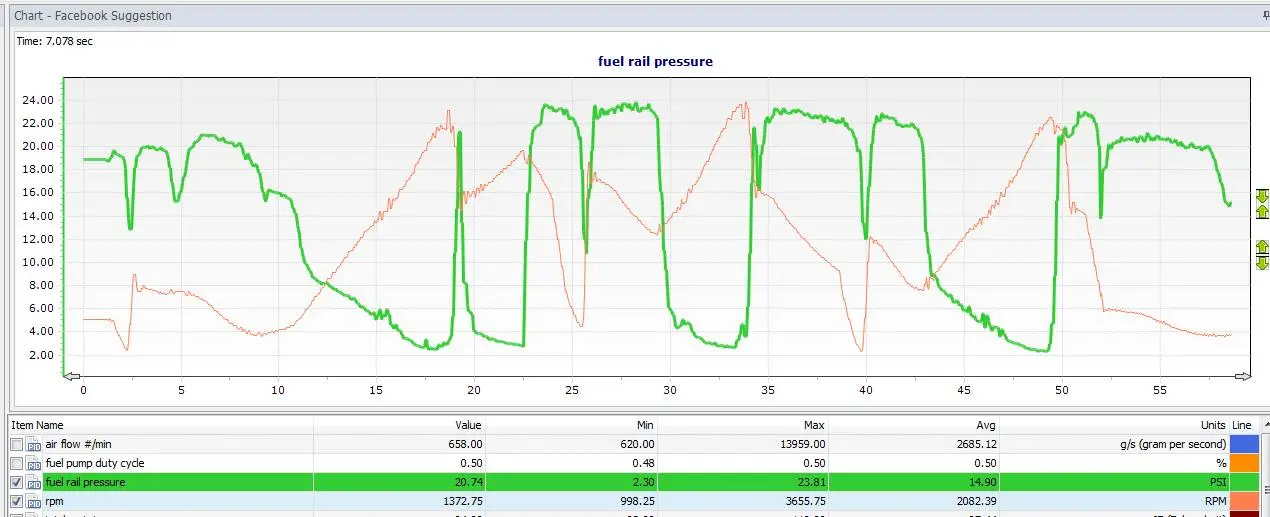

Interpretation of graphs: Graphs show a clear decline in fuel pressure in regards to rpm increasing. Looking for more suggestions and thoughts.

Confirm that the fuel rail pressure sensor is boost referenced. Is the intake vacuum reference line connected and leak free? Is there any evidence of raw gas in the line?
What has been done to rule out a ruptured FRPS?
Has the FRPS pressure reading always been soooooooo low? Should be around 40 PSI. Even at the starting point it's only 20 PSI.
I just pulled the vaccuum line off and checked if it was wet. I know it isn't much diagnostic effort on the FRPS but it was all I knew how to do.
