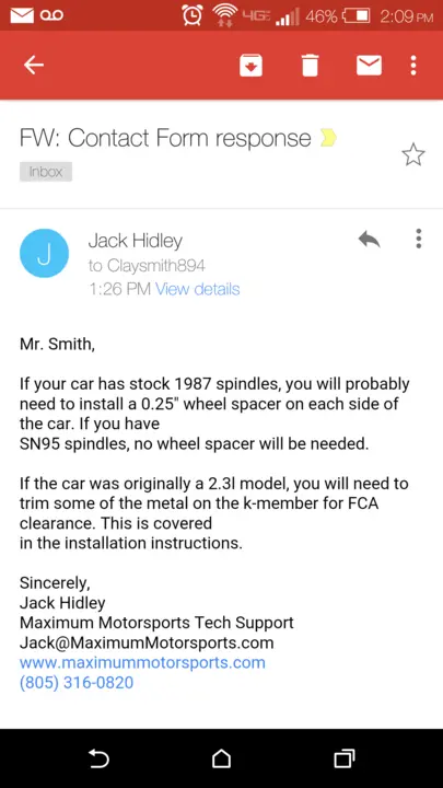

All I know is that I called UPR and they said 9" wide wheels will NOT work with coil overs. WTF? They said I need 8" rims.Don't think so and car is on the ground at ride height

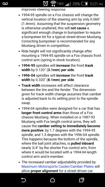

I could see why they would say that. It was veeeeeeery close.All I know is that I called UPR and they said 9" wide wheels will NOT work with coil overs. WTF? They said I need 8" rims.
