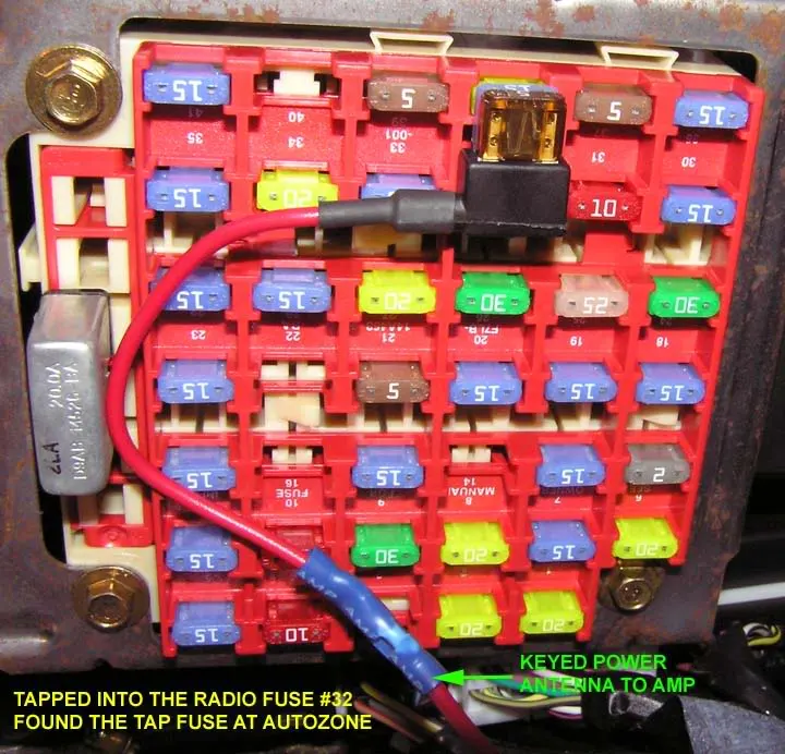

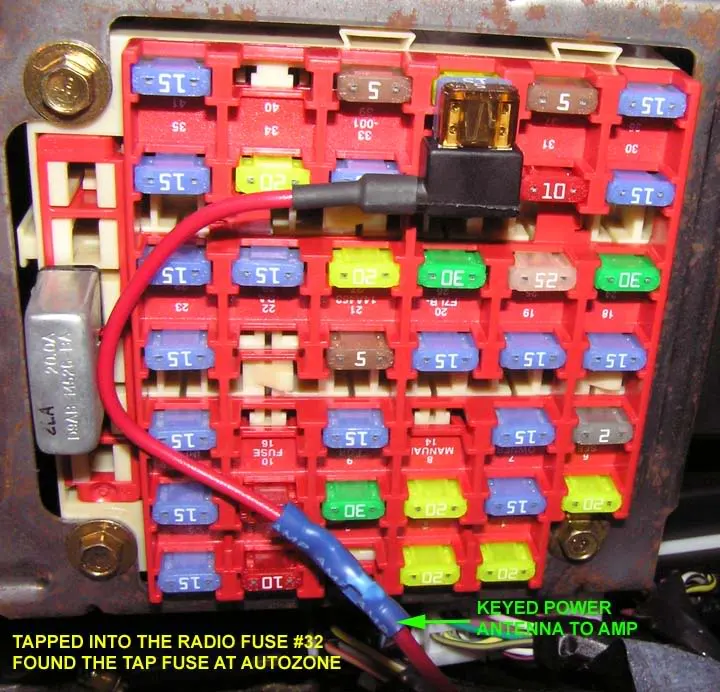

4point6 said:
http://www.mustangworld.com/ourpics/fcar/despeeds1.htm
Is probably the easiest way without new head unit.
That's similar to what I did and it works great. You just need an amp to drive the sub :nice: Also all the factory amps/speakers are intact and functioning.

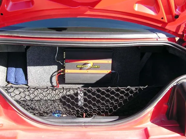

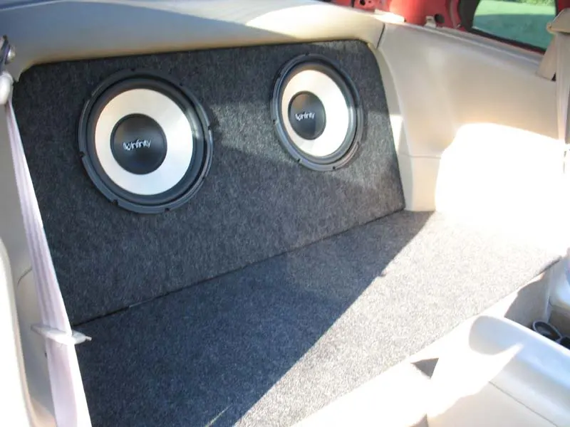

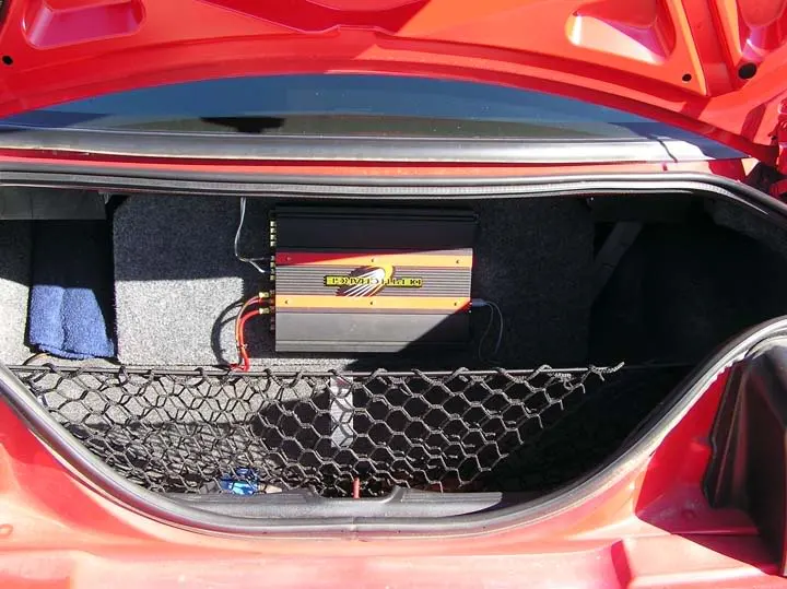

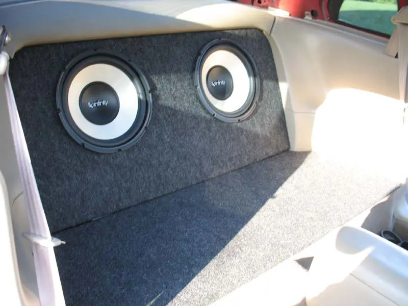

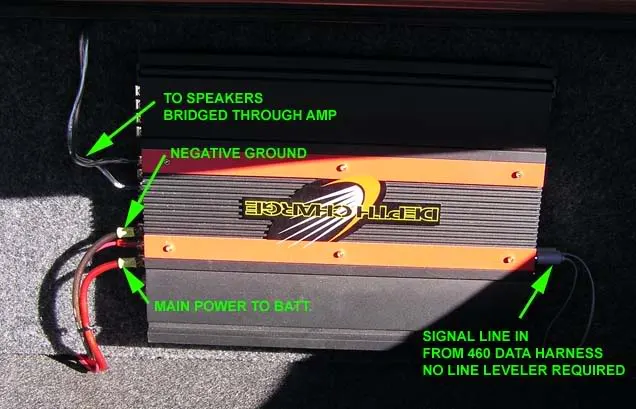

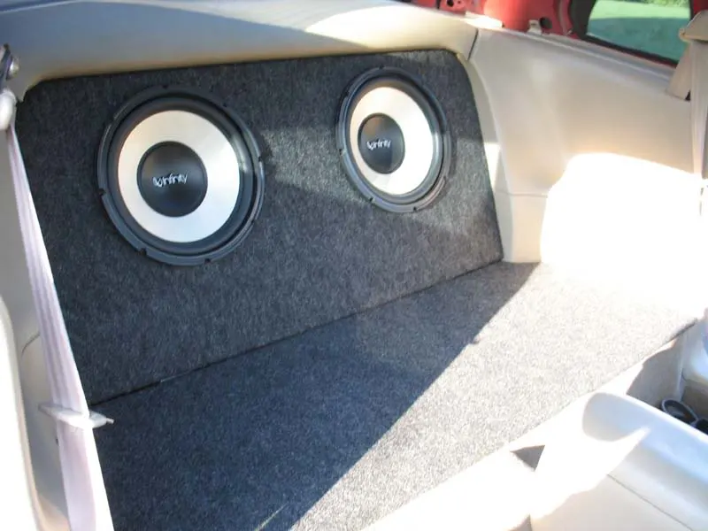

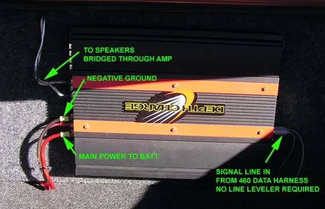

Jinx102672 said:
Before I get the comments, yea I know the box does not fit well and the amp is upside down. But heck, it was all FREE and it sounds awsome (shakes the steering column if I turn it up loud enough).
I have the base centered on the radio, gain controls on the amp are at minimal, the high pass filter is turned on and it sounds great. Nice solid base hits with no distortion and no trunk lid rattle.
Thanks for everyones help and input :nice:
