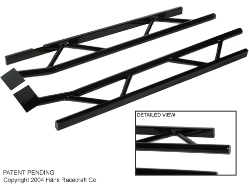

A guy at the shop recommended Hans. After some research, I am getting them put on next week. They look different than the ones you mentioned. More expensive also, hopefully they are not too heavy. Seems like they will be worth it since I will be regularly autocrossing and road racing.
www.hansracecraft.com
Copy of the Global West product
