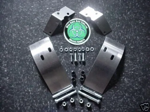

To hell with those torque boxes.
If they're as beat up as you're describing, cut em out, install Wild Rides replacements, and never look back:
Edit: What those guys said up there is spot on. This just eliminates all the guess work or battle box installation.

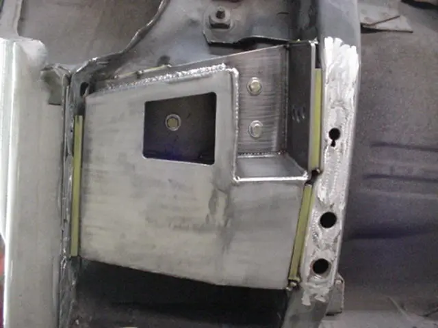

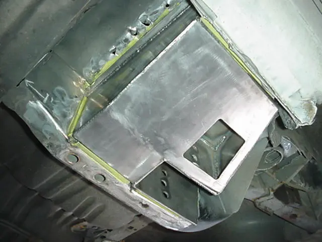

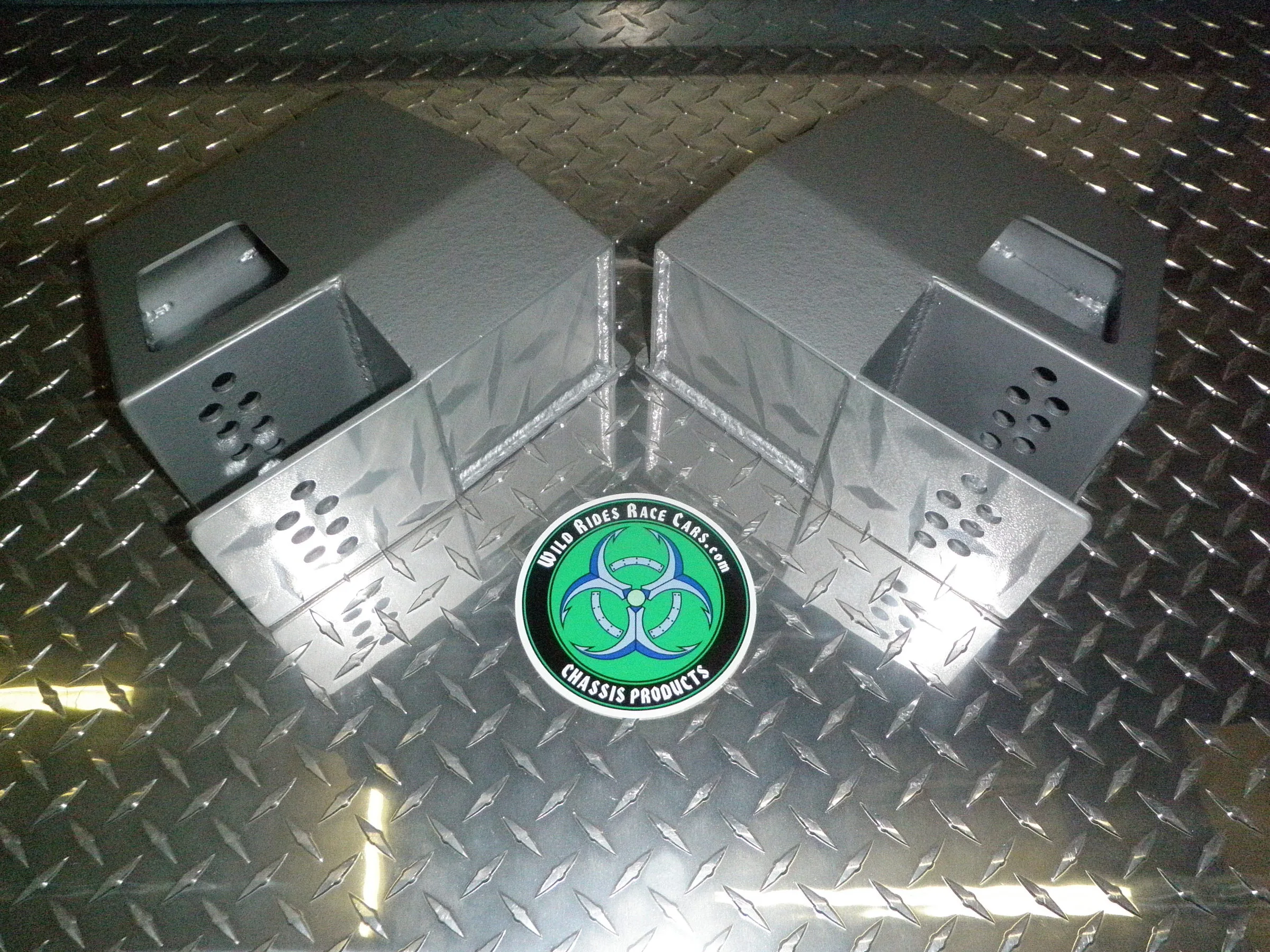

Show a picture of their lower boxes as well Noobz, I'd do it myself, but I'm an idiot.
Reactions: Noobz347
Good call:
Here's an image of the reinforcement kit for the lowers.
...and the kit for the uppers if you decide that yours are salvageable.
This last image would be in-place of the replacement kit in my first post, reinforcing your factory uppers.

Nah Noobz, the have an entire box you weld in, it completely replaces the factory box. For the lowers, just to be clear.
I've owned many 10-12 second fox mustangs and not one thankfully needed to have the entire floor section replaced. Only the battle boxes welded in and welded up the stock stich seams. The lower ones are much easier than the uppers- you have to gut the entire back section of the interior usually- seats, carpet, sound deadening, paint, and then cover everything with welding or heavy blankets.
Ford did some stupid things over the years but stitch welding the torque box seams ranks up there. It would take all of 2 minutes on the assembly line to fully weld those in properly.

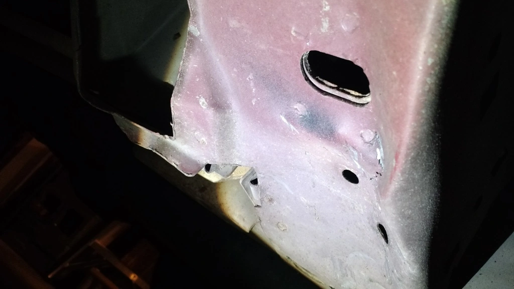

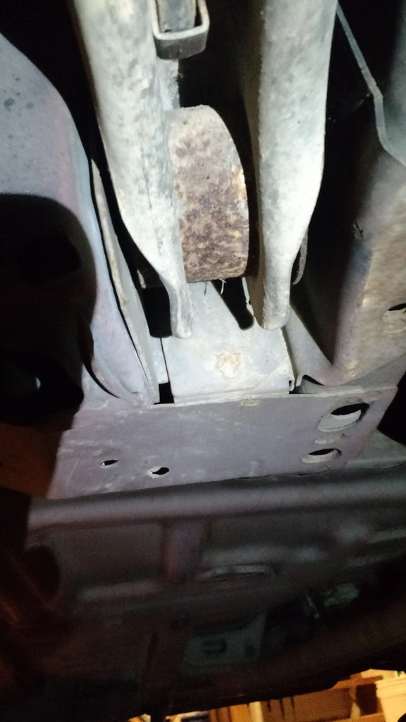

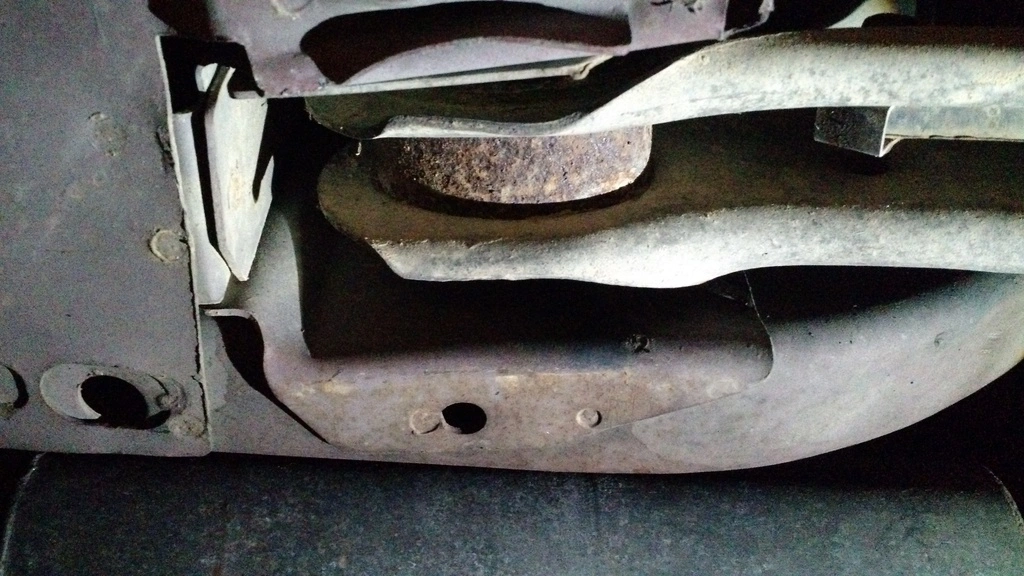

Finally got the car up to take some pics of the torque boxes.
The passenger side is the worst. Both look like someone put jack stands on the big square box and dented them in. Damage isn't terrible, but it's there.
Driver Side:
Lighting isn't great, but if you look you can see that it's dented in. Looks a lot like a jackstand or some other support was put there.

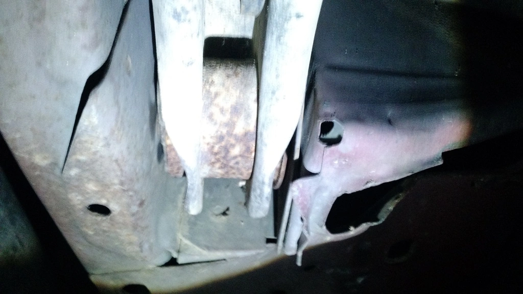

The rest looks OK to my untrained eye:

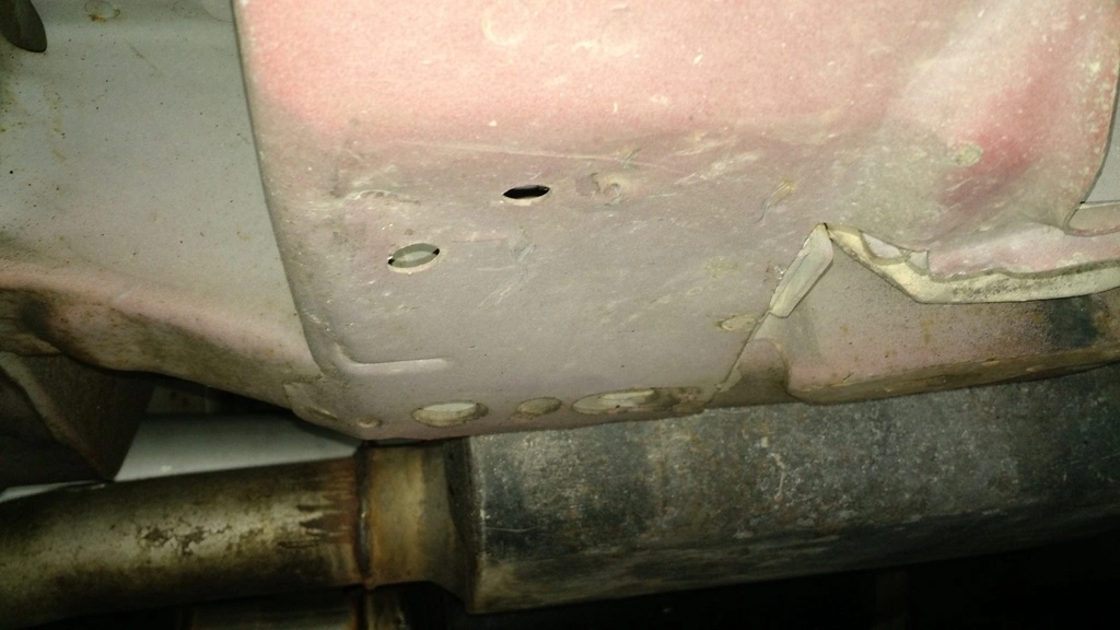

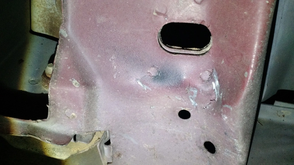

Passenger Side is worse where the jack stand was probably placed:

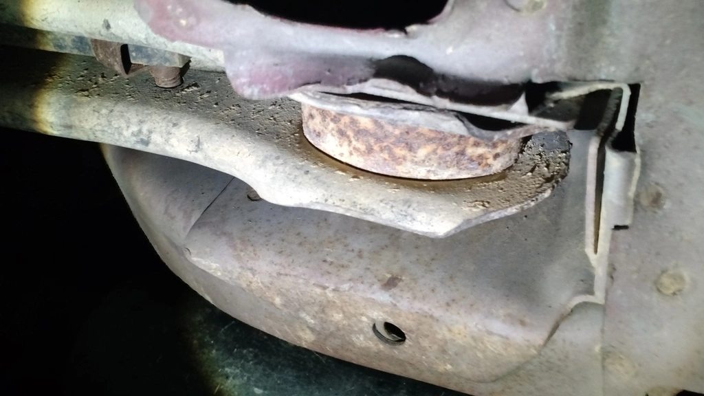

Again, the rest looks OK to me:
There is some wavy/bent material around the edge of the access hole, but again looks like some piece of a jack/lift/jackstand.
