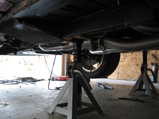

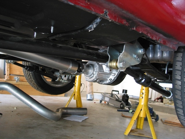

I have the GW bars welded under my vert, there are ZERO issues with exhaust clearances since they basically follow the line of the sub-frames. When I bought them GW was the only company that made them for verts, and they ARE different from hardtops so YMMV. Thought I'd post these pictures of the underside, so you can see how they fit.
You can just see the front of the bar on the right hand side.
The rear of the bar is within about 0.75 of the cal-trac mount, but tons of room on the exhaust side. I should probably mention that these bars will NOT work with Shelby-style trac bars though.
