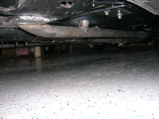

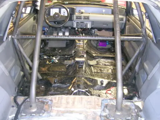

Or, you could do what I did when I had my 6 point installed. Have them weld in a set of subframe connectors that attach to the main hoop (making it an 8 point). Here's how mine is.
the two diagonal bars coming off the main hoop go through the floor and are welded to the connectors underneath.
