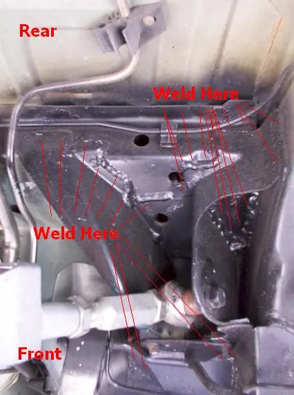

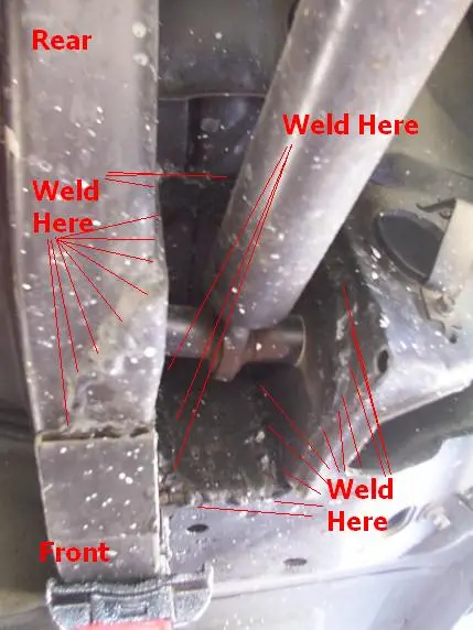

Another vote for Rick91GTs lower torque box kit. It's top notch and good price, and a really good guy to deal with.
As for the upper tq boxes I just had them welded by a buddy.. Basically you just weld any of the seams where they mate up the the floor or frame rail or bracing.. as well, there's a sort of main plate that runs from one side the to the other on the underside and the upper tq boxes attach to it [kinda - been a while since I been under there]. Tack that thing to the floor in as many spots as you can.
I attached some picks Rick91GT sent me as far as where to weld on the upper and lower tq boxes.
