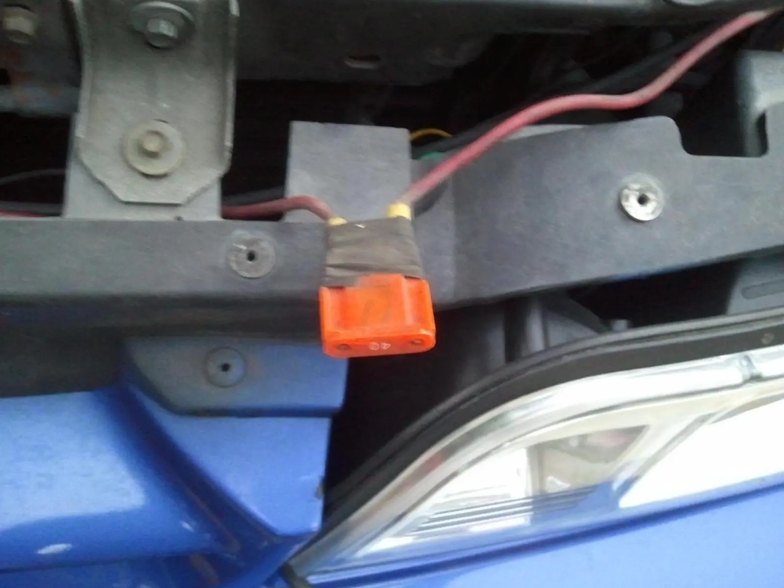

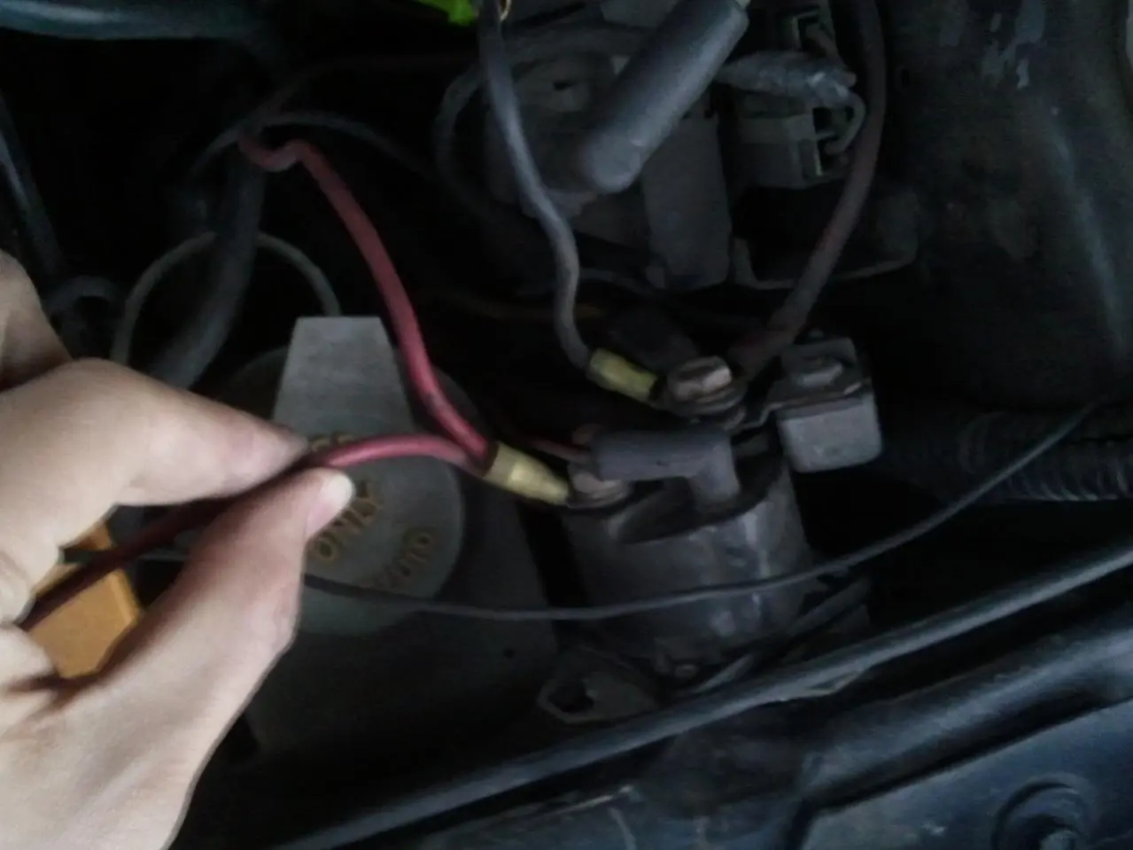

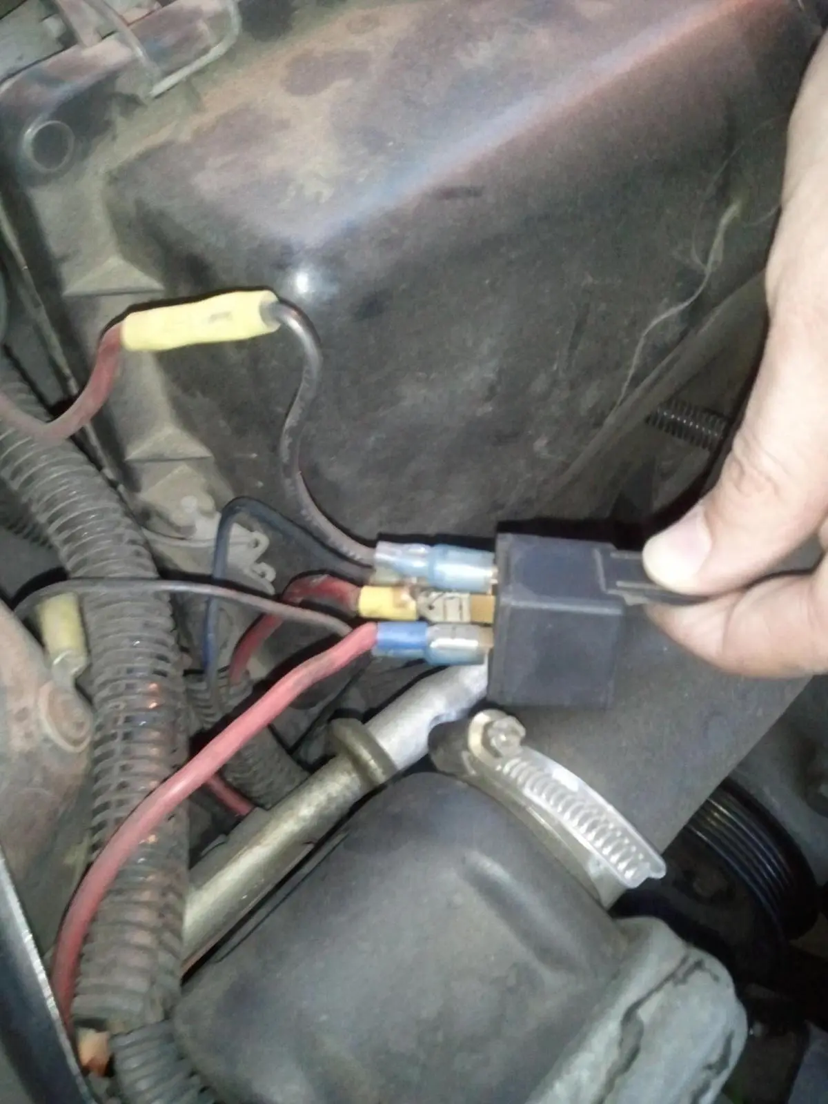

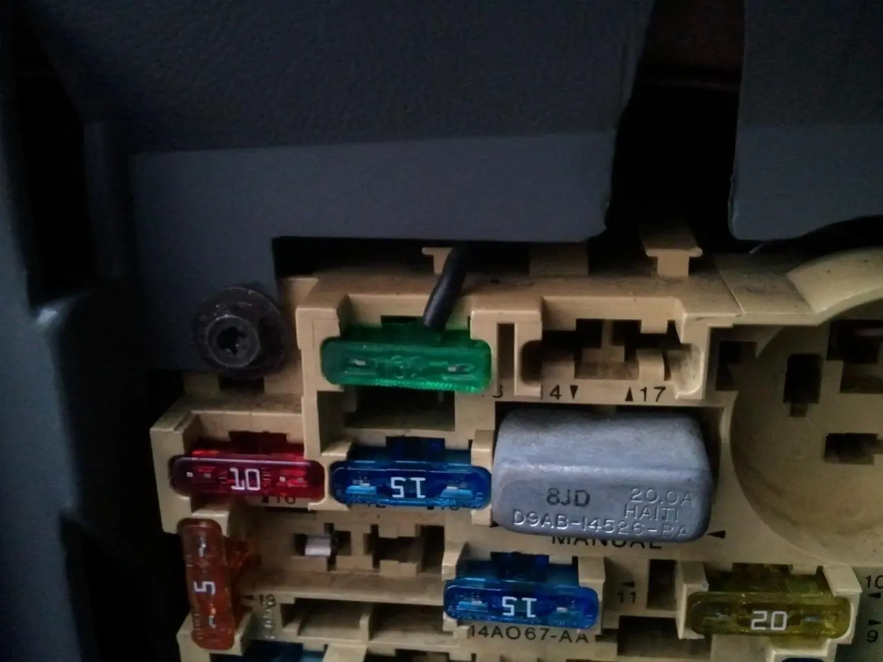

Hello DJG i have an 89 mustang that i converted to use an electric fan i bought at a junk yard from an old Taurus. i don't know how the flex-a-lite is wired but maybe this will help you. i went through hell to get it to wire up with similar problems to yours. first i tried a kit i got online that had a fan controller i couldn't get it to work. it only has two leads coming from it, power and ground. i bought a generic relay from autozone for 4 bucks and a 40 amp fuse. from the relay one wire is ground, one is power and one is to control on and off. i got rid of the controller and wired the fuse to the power line to the power distribution block then the controller wire directly to the fuse box. so the fan starts every time i start the car at full blast. it's been 5+ years with no overheating problems i live in California and have driven to Vegas to problem. i posted some pictures so you can see what i did. i don't know how the flex-a-lite is wired but maybe this will help you.
