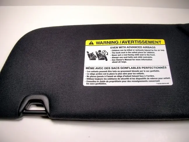

The problem...these dumbo stickers:

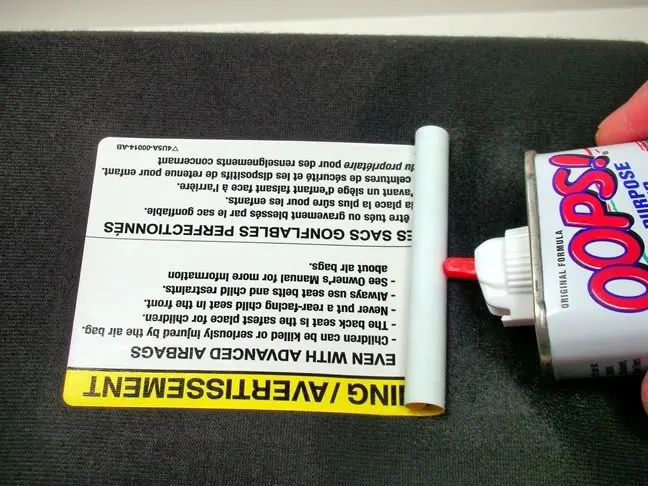

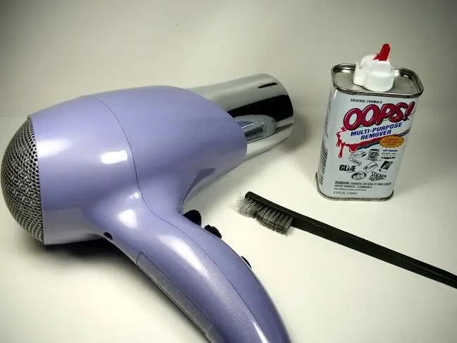

The solution...OOPS, a tooth brush and a hair drier. The visor was taken off by removing 2 screws with a T25 Torx driver:
I just started soaking the edge of the sticker with the OOPS. Then I started peeling it back

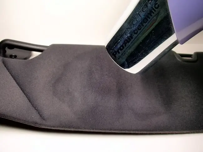

The cloth was wet and wrinkled so I hit with the hair dryer to dry and smooth it out:

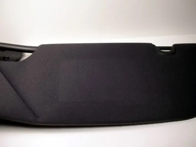

Here's the finished product. Under the bright lights you can still make out where the sticker was. Inside the car I don't see it:
