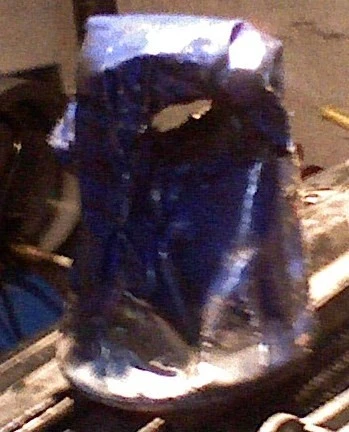

Super stuck oil filter! WTF! I've now crushed the end down 2 wrench sizes.

Bashed, torched, crowbarred and a jack handle beaten through the middle.
I smacked it with a mallet on the end. Then I burned around the outside with a torch. Then I bent the ends back with a mini crowbar. Finally, I took the aforementioned hydraulic jack handle, held it up to the side and proceeded to deadblow mallet it until it was sticking halfway through. I had to stomp the end with my foot but it finally started moving.
This was one determined filter!

You should have changed the filter when you changed your oil the first time!!! SEcondly, you should have changed it when the motor was at operating temperature, because it would have come right off. Third, get big Channel Locks and it will come right off.
