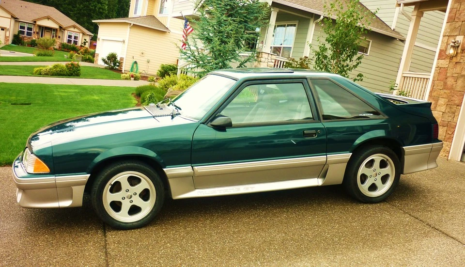

Hi guys...I recently picked up the pictured '91 GT...It has a basically stock 130k engine and a 3.73/31 spline Moser rear end...Along with the car I also got the following, all of which are uninstalled, for free - Cobra upper/lower intake and 65 mm TB, GT40 heads (need to be reworked), Paxton SN2000 supercharger (has a bad bearing and needs to be rebuilt). At a minimum I am planning to get the short block rebuilt, but where I go from there is still open for consideration. My goal is around 325 RWHP, with a higher torque number. I'm basically considering the following 2 options.
