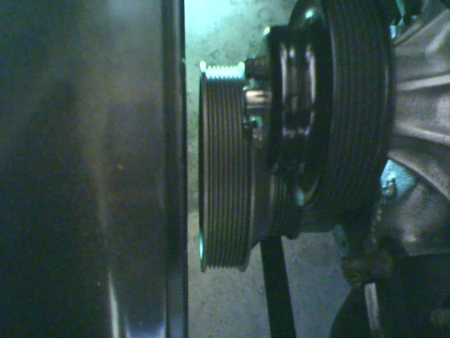

I have about 3/4" between mine and I have to upgrade my rad due to poor cooling. Right now I have a stock rad, Black Magic Extreme fan, and Vortech T-trim.
