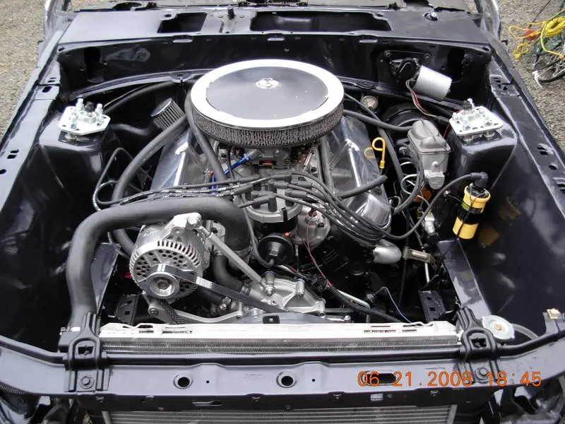

You need a march, summit or other brand alternator mount with the adjustable tensioning rod, it will do away with the stock alt. bracket and tensioner and look much better. When you do this you need a standard rotation water pump and probably an aluminum grooved water pump pulley to avoid slippage. Here's a crappy pic of mine... check summitracing.com they should have everything
Nice setup!! That's what I'm looking for! Thanks!
