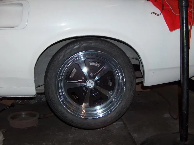

This is not to say “don’t bother”, and it didn’t stop me either. I run a TCP rack, roller perches, heim strut rods, Shelby drop, lowered 620s and nice Bilstein shocks, Baer tracker bumpsteer kit, and 1’ sway bar in front, with Maier leafs w/ poly bushings and Bilsteins out back, too. But you can’t hide that chassis; in fact, it becomes even more noticeable once all the slop is removed from the stock crap and the driver-feedback is improved from the new components.
will agree that if money is no object, then go with the IRS, or a good 3 link rear. On the wheels, 18's are the biggest I'd do just because any bigger and theres not enough sidewall to give a nice ride on a street car, just my opinion of course, but I like the 17" for a magnum 500, heres a picture of mine just to give you and idea. This is on a 69 fastback.
