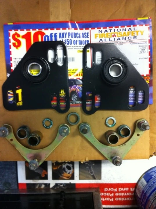

My Steeda Caster / Camber plates were a bit clunky. I had the Hotchkis brand on there before with the urethane bushing and there were zero clunks. The looked much better too.
Steeda's

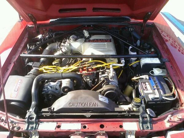

Its far from stock, just don't know how far...lol. I'm the second owner, first owner died and I bought from his wife. She said he had over 6g in the motor. Everything is ARP even the thermostat housing bolts. Think it's a stroker but will never know till I tear it down for a build. It has a cobra upper and lower too.
