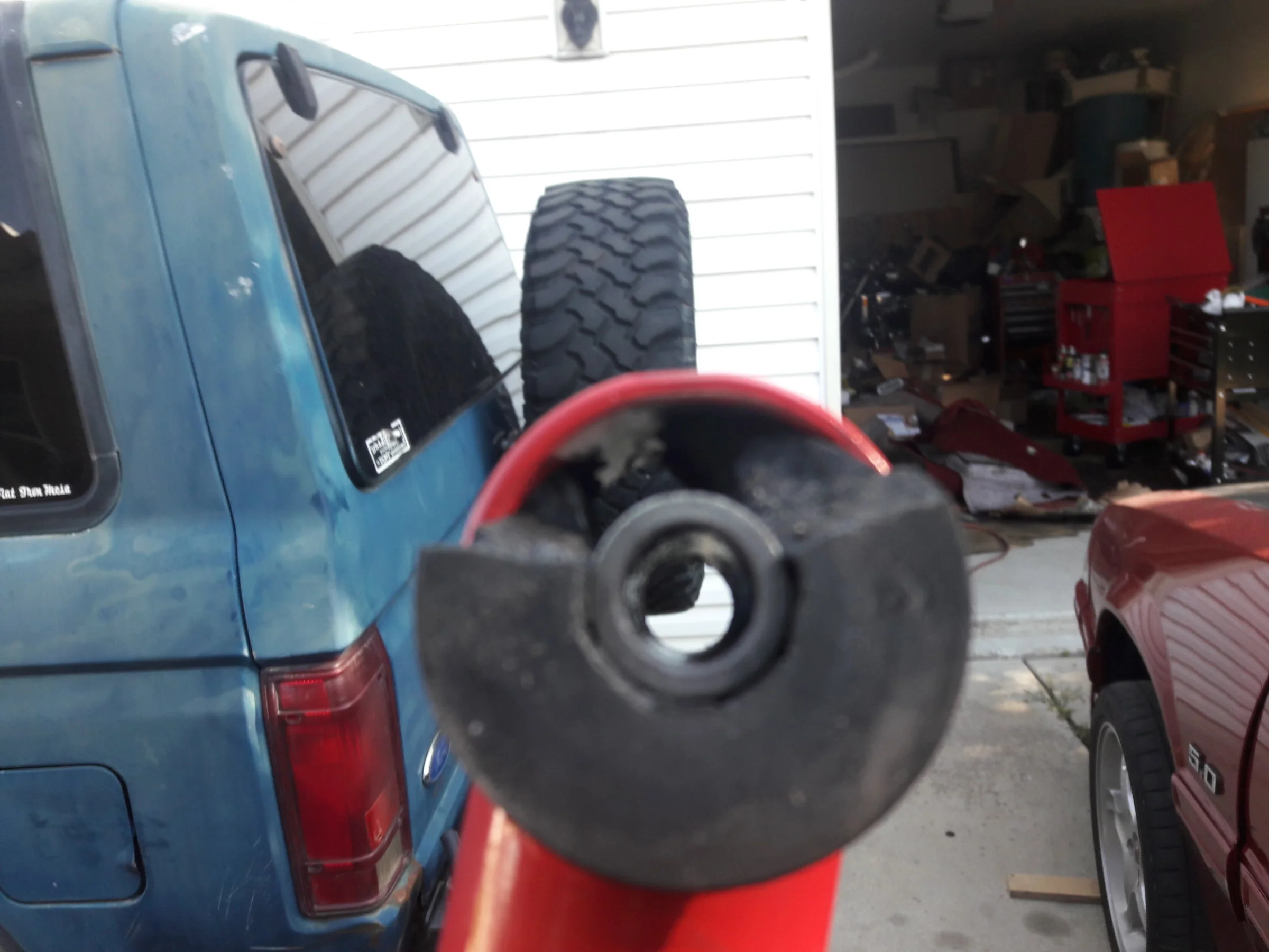

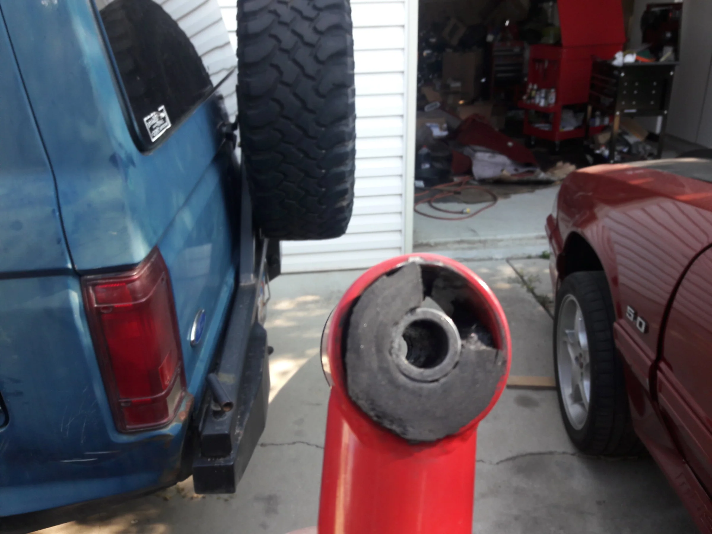

After 6 months the bushings in the upper control arms were shot on mine
And yes i greased them with the appropriate grease
