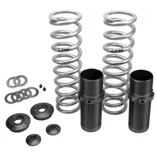

In my opinion, The “night and day” difference in getting a better ride out of these cars, is bailing on the factory spring setup completely, and putting a 4 corner coil over setup back in its place. The current car is my third Fox that I have done that to, and every time the car went from a teeth jarring/ kidney punching, rattle trap, to a nice firm “bump“ when going over a dip in the road.
Replacing the front springs with any of the aftermarket coil over kits is as easy as changing out the strut, and infinitly easier than changing out that factory bound up man killer that’s just waiting to come flying out from under the car once you try and remove it.
All thats required to make any of these kits work is a properly working front strut to start with.
The same goes for the rears...LMR sells a single adjustable shock/coil over that goes in place of the factory shock and again, it’s just as easy to change out.
It won’t fit into your budget, ( both sets as pictured are about 1050.00 from LMR.) But it’s a far better solution than putting in a “ one stiffness/ one ride height” factory replacement. If after installing the above system the car is still too stiff, it’s only a matter of changing out the 100.00 springs with a lighter spring rate. Ride height is adjustable as easy as turning a screw, and it’s a sht ton lighter than the factory spring.
