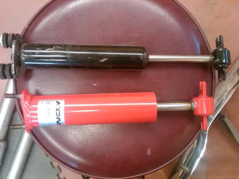

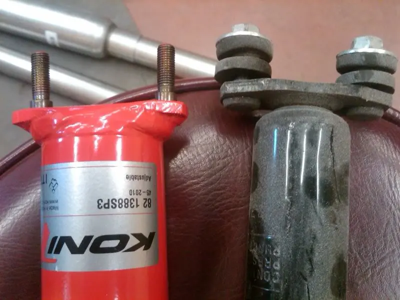

But, I really wonder if those GR2 shocks are really a good shock or just marketing? I wonder how large those shafts and bodies are on those? When I held my new Koni's up against my old shocks (cheapo's) there was a huge difference in weight and tube sizes.
Here, I found these.
