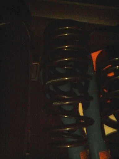

I got two springs from a friend of mine, he couldn't remember whether it was the front or rear springs. Can anyone tell from the pic which one it is. I know the pic is dark and bad quality. The two springs are CJPony parts. I'm jus going to put them one for now until i can get a full set.
