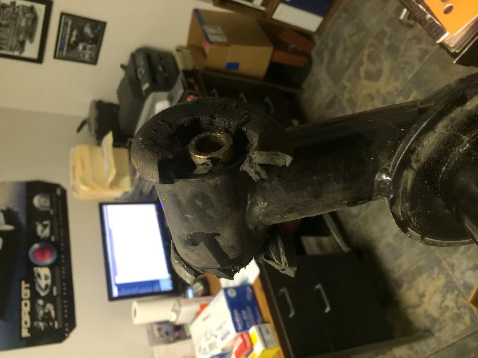

Attached is a photo of a lower SVE control arm a buddy of mine had installed on his car and drove a total of 500. He has a pretty stock car with 43,000 miles, 373, exhaust, pullies, cobra intake. The car is never dragged raced and lives the pampered life. He decided to swap out the stock control arms because the bushings were 20 years old and he thought it would help tighten the suspension up. Within 100 miles the car started squeaking and it got to a point where he couldn't drive the car without hearing some loud rubbing.
He brought the car into Realspeed and this is what they found.
Now I'm not a fan of the SVE products only because I dont feel they suite my needs, but I would have thought they suited his needs.
All this being said my buddy call LMR about this even though he bought the control arms a year and a half ago. They 100% stood behind the product, refunded him the cost, forwarded him new weld in torque boxes, and offered to pay labor. I was happy to hear LMR did this to keep a customer happy, this wasn't to slam SVE he may have had a defective batch.
Great job LMR!!

It's great that LMR stood behind their product and went above and beyond. I have to question something though, how the heck did all that damage happen to the end of the LCA that attaches to the axle??? Did he go offroading or run something over? :scratch: Also, why did LMR give him torque box reinforcements when the bushing that failed was on the axle end? Did the control arm move around and damage his torque box?

Yes the control moved around and damaged the torque boxes, he's fixing them just to be on the safe side. The sad thing is they failed and were never really under heavy load. What I mean by that is he never beats on this car off the line, it's babied.
The whole process renewed my confidence that there are good companies that stand behind they're product.

What i discovered is the lower control arm bolt size changed (I think with the sn95) to a bigger bolt, and there are companies selling lower control arms for 79-2004 mustangs. So what happens is the control arms all have the bigger hole size to accommodate the larger bolts of the sn 95 and up BUT if you use them on a foxbody with the smaller bolts they will technically "bolt in", but the smaller bolt walks and moves inside the control arm eventually destroying the bushing and possibly the torque box.
I had bought thousands of $$ worth of parts from LMRS and they are a great company to deal with. That being said, this is why I tell people to ONLY buy MM control arms. Cheap and/or Chinese made control arms do more harm than good.
There are certain parts you need to buy quality and do it right the first time.
Real glad to hear LMRS stepped up and not only refunded the money but paid for the damage their part did. Other vendors like GMS are not as reputable when their parts fail.
