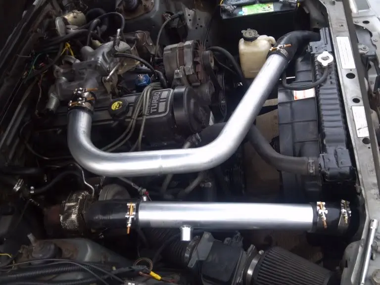

Here are a couple of pics, just for the heck of it
