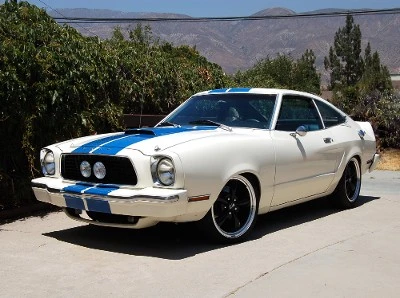

It would be hard to put a 17X9 rim on the MII. I have 17X8 in the rear with 0 offset. The tire is 225X45R17. It rubs on the rear of the fender where it folds under severly lightly when cornering. I have rolled the fender lips as much as possible. I have +35 mm offset on the front wheels with 205X40R17's. I can turn lock to lock and no rubbing. This does work and I have been driving daily for allmost 2 years. I went through two sets of front wheels till I found the right offset to work. You are free to use this information for what it's worth.

ive seen your car a few times on the web, i have to compliment it seriously!
i love the look!, how did you lower the rear?
