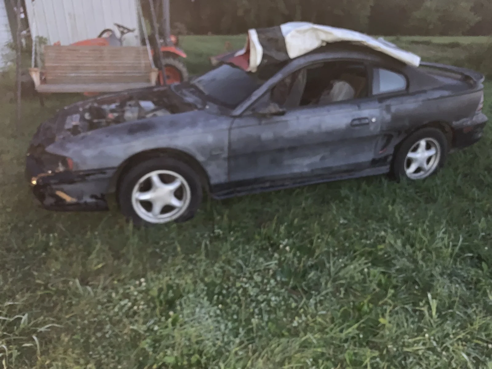

I did find this running 94 GT and I feel really good about the swap. I got the whole car for a steal of a price and traveled almost 700 miles to get it. I’m not too worried about the fuel injection because I think I’ve got myself talked into going with just a carburetor setup. My Convertible sits really low so can the GT springs be used Since you say the shocks and struts can’t be?

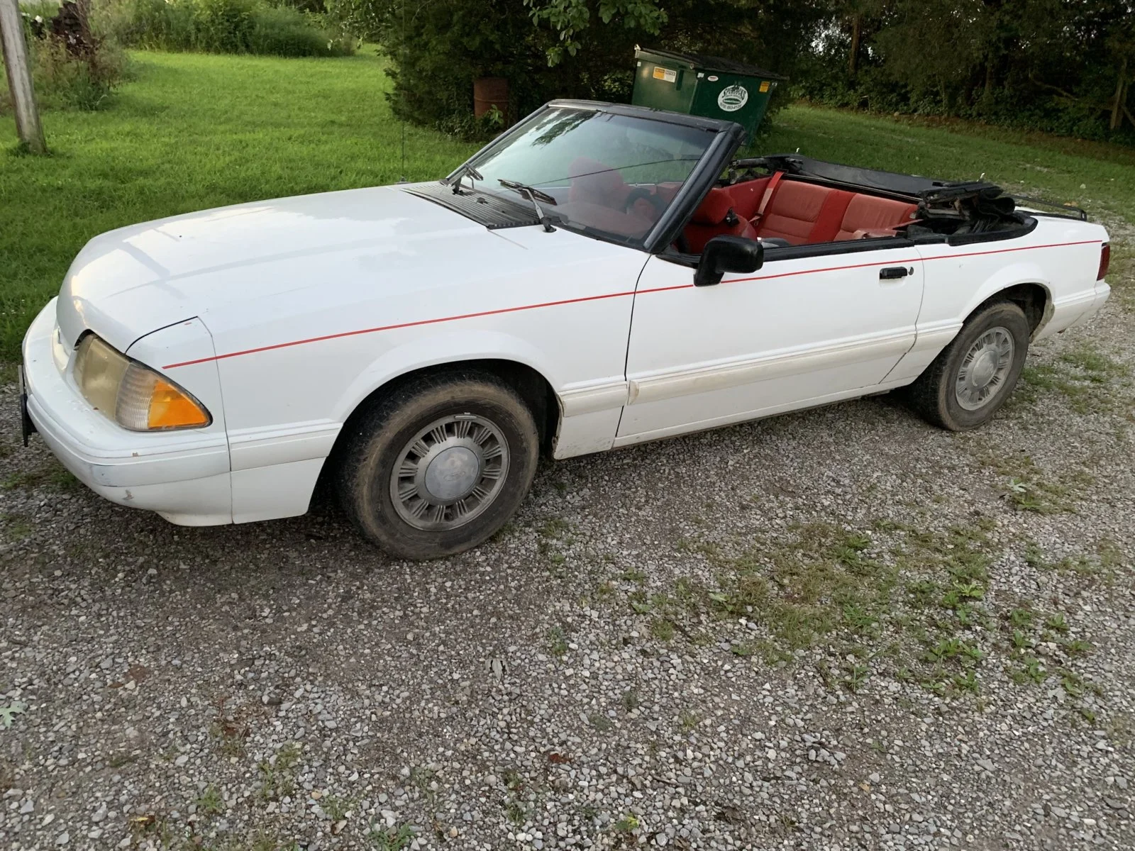

It is very straight minus the front bumper cover. The top does need replaced but was expected when I first seen it listed. Interior is all there and in good shape except the ash tray cover is broke and the rear speaker covers have a few cracks. It is very solid and couldn’t have asked for a better project for me and my 5 year old daughter to work on together.
