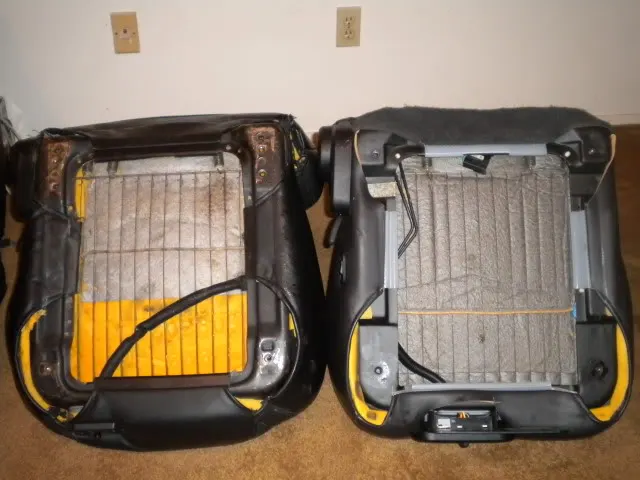

heres a side by side of the drivers seat bottom.
left=from the 94,see how its pretty much flat.
right=02 gt,the front of the frame recessed.the rear of a 94-98 track will bolt up fine,but at the front,there will be a large gap between the track and seat bottom frame.
