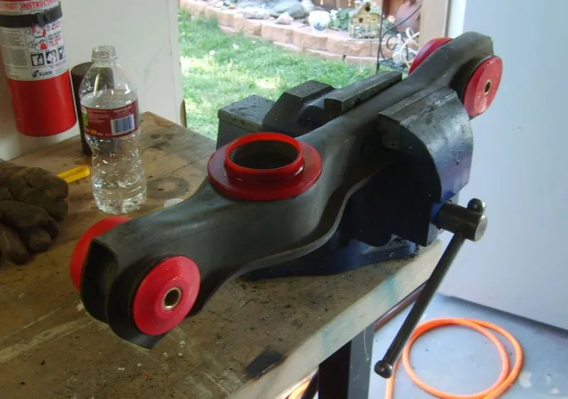

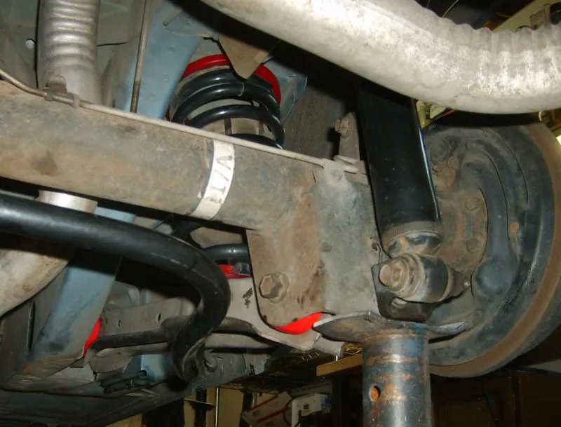

Anyway, it went pretty well. I did the jack up one side and remove the opposite spring trick, worked perfectly. Also used a trick I saw on utube for getting the old bushing out of the control arms, just heated the outer shell of the bushing till the rubber is smoking good, and then just push the bushing out with a hammer handle.,, Cleaned up any left over rubber inside with stiff wire brush. The Energy Suspension poly bushing slid right in after applying a little of the lube.
So I ended up not changing out the bushings in the rear end housing. I took the time to make myself a removal tool, but didnt use a big enought piece of all-thread, cause I twisted it off trying to remove one of the bushings, and it never moved. So, since those bushings looked really good anyway, I just decided to leave them .
So I have new rubbers in the upper chassis end, and new poly in both ends of the lower. I also ordered new poly spring insolators cause the originals looked pretty bad.
Took it for a nice drive after I finished today, and I must say it feels much better. Before there were times when the rear of the car would wobble back and forth, like a dog waggin its tail. It does not do this now,, car just feels much tighter, firmer, and more under control. The rear felt really sloppy before.
