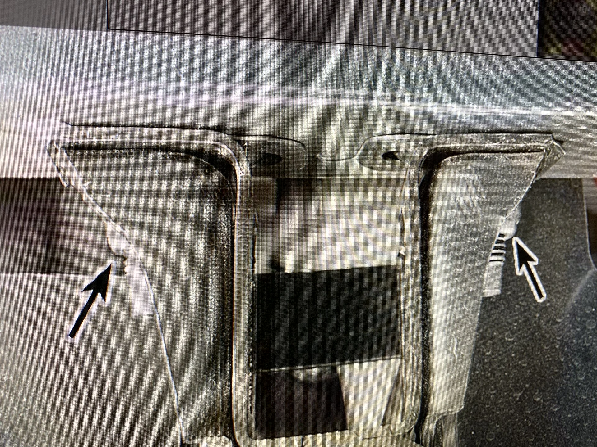

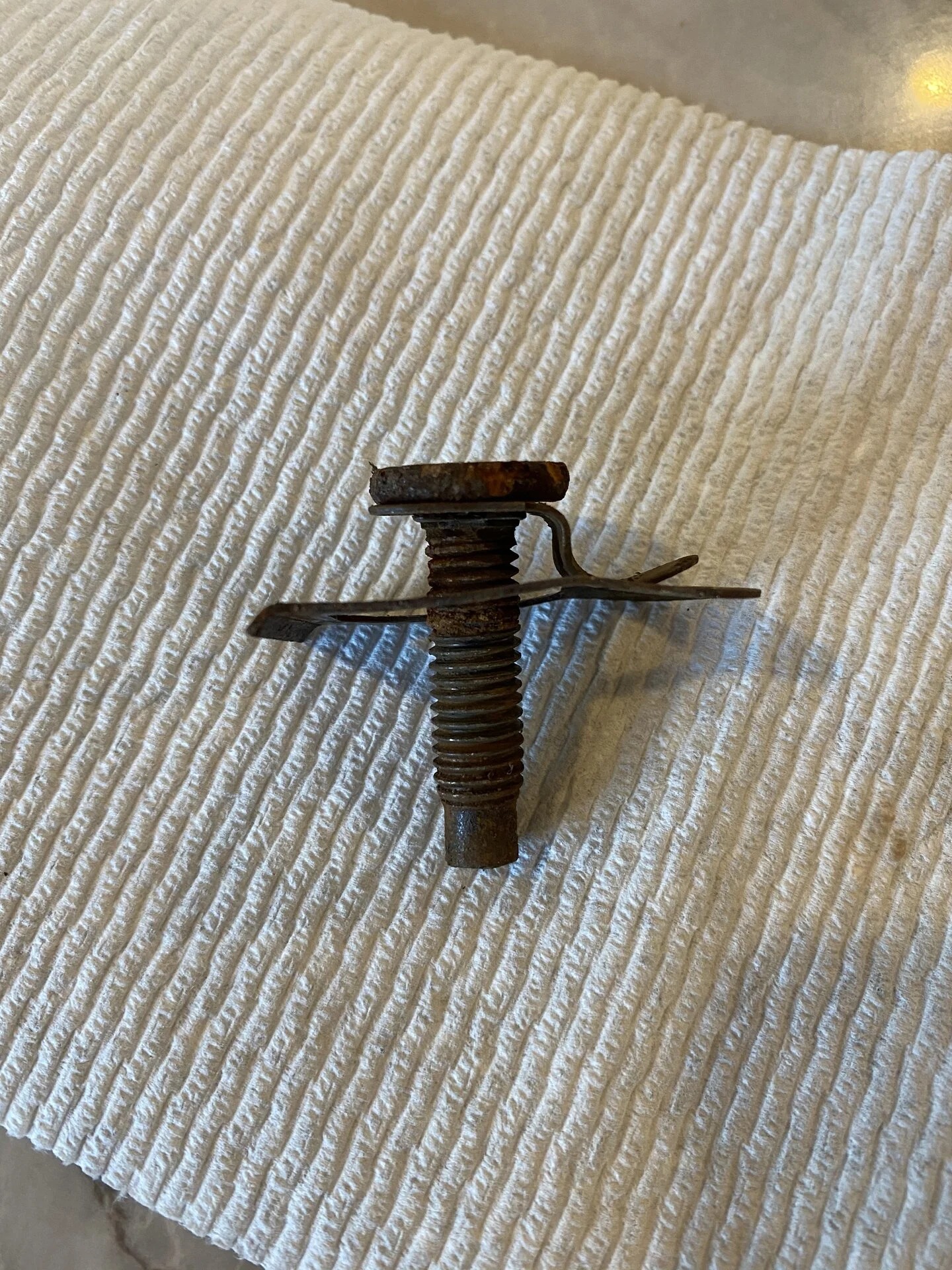

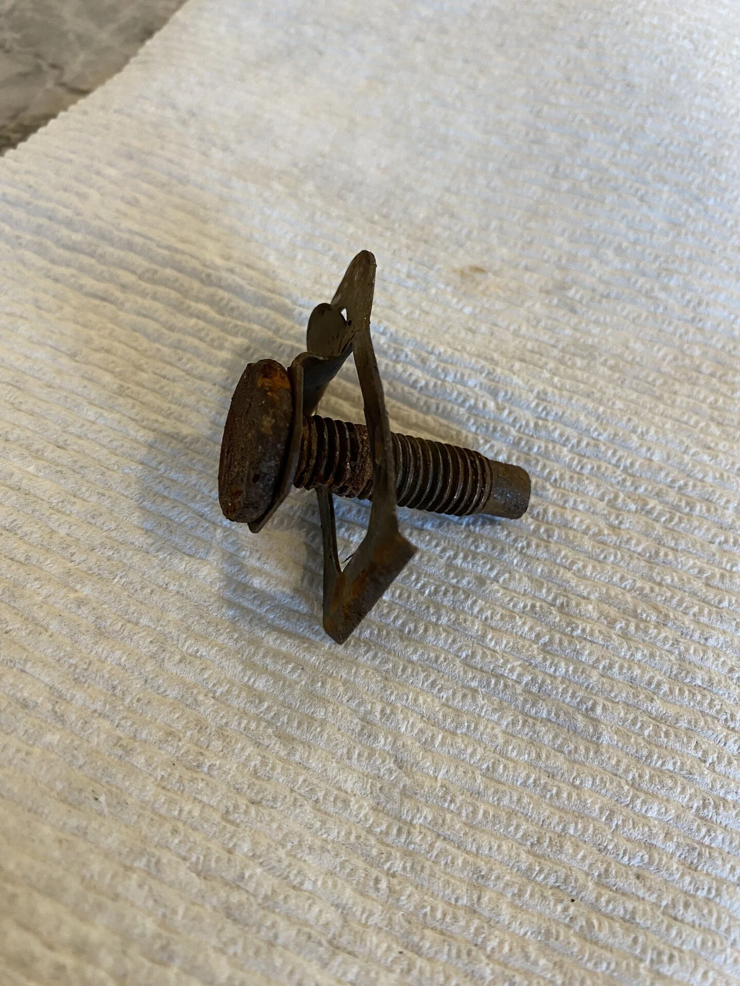

Hey everyone,
I took out my front sway bar and the off the fire stabilizer bolts broke off of their brackets (there the ones that install into the frame - pictures included). Does anyone know where I can find these? Looks like they sell them for 2003+ Crown Vics but I can’t find them for this car (‘01 V6 coupe). Any thoughts?
Thanks!

Well, Ford (https://parts.ford.com/shop/en/us/stud-7861853-1) sells them, but they are like $60 for the set of four.. Part #: N806729
Junk Yard is a much better bet. They will be a lot cheaper and probably even "discounted" if you are getting other bigger items that they wouldn't care about the 4 bolts.
Just when you remove them, tap them back in the holder so you can bend the holding tab down and put a flat piece of plastic or something between it and the frame, then tap it forward. Was easy to do without breaking any after breaking all 4 of my rusted ones and struggling to get the junk yard ones pulled -_-
