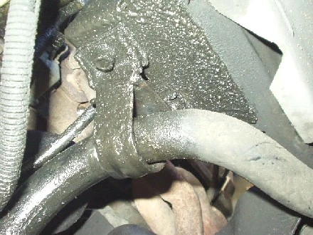

Today I noticed underneath the car that the driverside part of the sway is missing the bushing.
take a look at the pic. My car makes poping noises when i go over bumps and holes in the front end. BTW the has 171,XXX maybe all if the bushings are bad.
should i buy the Energy hyperflex master Kit
thanks

As for a master bushing kit ….I’d just replace the sway bar bushings and end links with the polyurethane ones in the front and the upper/lower control arms in the rear. Unless you’re doing nothing but road courses, a full master kit will be too harsh for daily driving and will shake your fillings loose.
i dirve mine every day just like i used to with the bar on, and through one set of high speed twisties every day at about 60+mph. i don't regret taking it off one bit. i don't have skinnies, but i do have lowering springs and i think that helps in not noticing the bar is gone. i dont drive retarded fast but i don't drive as slow as my grandma either. i'm fine. i'd say take the s.o.b. off, but do what you want.
I'd say get replacement urethane bushings for the stock type brackets. The kind they sell as a complete assembly doesn't drop the bar enough. Atleast it didn't on mine.

Ok i will order the kit.
does anbody know if the sway bar bushings are greaseable or non greaseable??
i encountered that when i was ordering from summit.
and just to be sure the stock sway bar diameter is 1 5/16?
