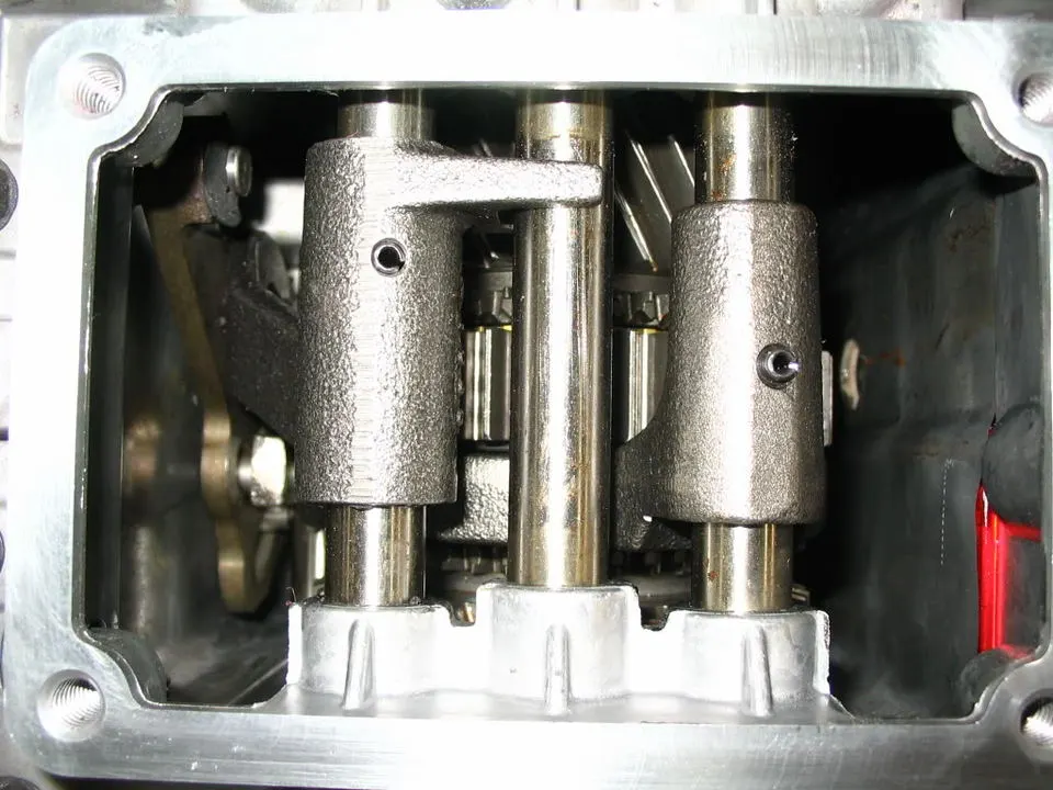

Anyone familiar with the T-3550 insides?
My T-3550 seems to be touching the tunnel stiffener with one of the inspection covers. As well as relieving the tunnel stiffener, is it possible to remove the offending T-3550 inspection cover, skim machine the casing, retap the inspection cover bolt holes and re-install the cover?

search kiesler's site. they machine one of the plates on the side to clear as you have questioned. i took the plates off to see if i could do it and decided against that route.
here is what it looks like under one of the plates for your reference.
