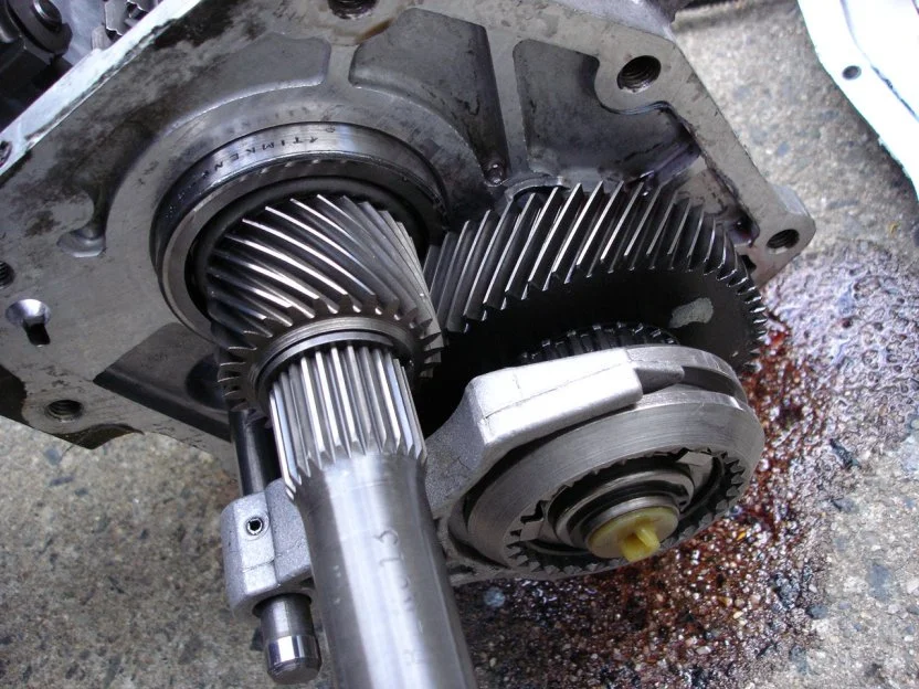

You can see the snap ring in this shot on the hub. There is 1 snap ring for the synchro hub and another snap ring holding the 5th driven gear (the small gear). Usually i remove the snap ring and drive the roll pin out of the 5th gear shift fork and take the entire 5th gear synchro/fork out as 1 unit.

Thank you, Mike, for the great photo. A pic really is worth a thousand words. Unfortunately the cluster gear shaft on the tranny in your pic is slightly different than the one I'm looking at on my workbench. I believe difference is the same as described by Chris Neighbors at page 16 of his August 2002 T5 rebuild artcle, pomoforacing.com/tech/T5Rebuild2002.pdf . I wish I could copy and paste that page but because it's in pdf, I can't. As Chris explains the difference, "Borg-Warner made an attempt in mid-'92 to relieve the grinding [when shifting into reverse] by piggy-backing a synchronizer and blocker assembly on the fifth gear synchro. The attempt was to slow the cluster gear a bit. . . ."
Anyway, yes I drove the pin out of the shifter fork, and I also removed the external C-clip from the end of the cluster shaft. This allowed me to remove, in order, (1) an internally splined washer which locks into the cluster shaft splines and which retains (2) a black conical washer which fits inside of (3) a brass "blocker" ring, which fits inside of (4) the synchronizer sleeve. Also removed are the three "inserts" (the little metal rectangles that look like tiny cars) and one of the two synchronizer springs. (You can see most of these parts in p. 16 of Chris Neighbor's PDF. You can also see some of these parts, as used in the pre-'92 T-5's, at Figure 3-14 of the Tremec Service Manual ( http://www.ttcautomotive.com/English/products/T-5.asp )) Also, the shifter fork necessarily came off with the synchronizer sleeve. But the inner ring, the synchronizer hub, will not come off.
So that's my question. Why won't that synchronizer hub come off? What's the trick?
Hmm, ok so you have one of the synchronized Reverse T-5's. Unfortunately i have not had a chance to rebuild one of them yet so what i said before may not be accurate.
Without any pictures, diagrams or expeirence with one, i am afraid i cannot be of much help to you. Sorry.
