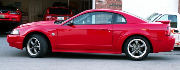

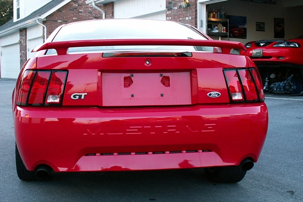

What's a lift? :lol:
AODE's are quite large and heavy.
My car is shown in the background on the following pics:

Getting the car as high as Paul showed us is what you want, if your stands go that high. I didn't have the cars I've worked on that high and the trick is to pull it out so the highest part of the bellhousing comes out through the front wheel well area. Also, if you have a short set and tall set of stands, use the taller ones in the rear so you can support the car by the axle. Alot more sturdy IMO and when you go to reconnect your exhaust, the rear will be loaded down and you don't have to worry about pipes hitting when you let the car back down.
