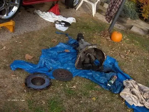

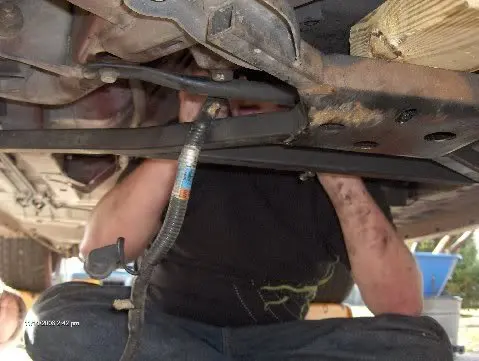

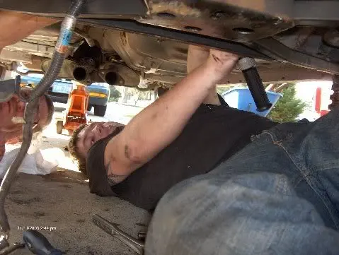

I did my clutch on tiny jackstands replaced my rear main and pilot bearing... if your doing the pilot bearing... rent a slide hammer... makes it alot easier here is some pics of the room you will have to work with...
Once the trans is out you can even get a nice seat...
