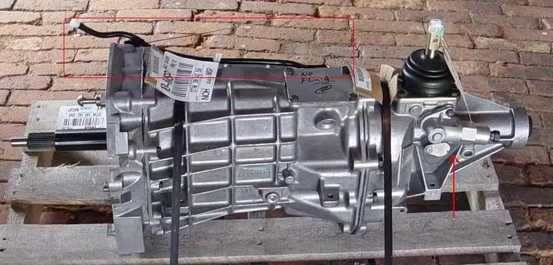

There a black hose looking thing that comes from a plate that covers a part of the tranny, Whats it for??
Theres also a connection right next to the shifer what do i do with it????

Here is a picture of my T-56. It is the viper version, but I would imagine that visually they are pretty similar.
The black tube that I put the box around in the picture is just a breather tube. When installing the tranny just make sure not to kink the hose, or have it pinched off.
If the connection next to the shifter is the one that I pointed the arrow at, that is the reverse solenoid. It makes it hard to put the car into reverse. I didn't hook it up to anything, so I just have to push through the solenoid to get into reverse. I suppose you could hook it to the brakes, or to a switch that would activate the solenoid and make it easy to put into reverse. I am pretty used to it now, so it doesn't bother me.

ok i got all my question thanks guys, i do use my crossmember. I already have the relay hooked up all i need to do is connect it to the tranny. Ill be starting later tonight
