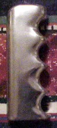

I was goofing around in my dad's old truck the other day grabbing some gauges when I noticed an old Hurst T style shift knob on the floor. A friend who was helping me said I should polish it up, but I kinda disreguarded it because I wanted a leather 03 cobra knob. Yesterday I realized that with a small knob I can only get two fingers behind a shift rather than my whole hand. So I went outside and grabbed that shifter. I brought it downstairs, sanded it a bit, and bang, it was shiny as anything. The only problem was that it didn't fit the threads on my shifter, it was to big. Solution: I dremeled out the old threads, and used a healthy amount of JB Weld to secure a hex nut of the appropriate size into the hole. The nut was already snug in there, but the JB will keep it solid. I then took a small washer and fastened it to the bottom of the nut, just to hide the hole and the epoxy, and it came out looking great. I put it in the car this morning, and I love it. I can shift harder, get more of my hand behind the stick, and it is comfortable, not to mention it looks good with my billet shifter bezel. I will post pics later. Tell me your thoughts...
here's some pics:
attachment.php
attachment.php
Heh, my locks froze ( I washed the car today, damned road salt...), so I got in through the hatch and was in the back seat taking those pics. BTW- my camera sucks... Thanks though. I like it more and more every time I look at it. And it works very well.
damn how old is that cam lol.....is that bezel made for the 87-93? cause i thought the upr thing was the whole square flat piece that goes around...that looks like the bullitt one. or the one that fits the newer stangs...anyway...looks ok.. the gray knob matches the interior pretty well.
The bezel can be bought on Ebay, mine cost me 45.00. It is made for the 87-93 with t-5, but they make them for all different models. I did do some fabrication, because the original threads were 3/4", and I had to reduce them to 12mm. By dremeling, epoxying, and finishing, I did fabricate a shifter capable of fitting in my car. I had to start with something, which was an old, tarnished, roughed up t handle.
On a side note, anyone know how to make that thing really shine? I used finishing sanders on it, then rubbing compound. I am gonna put polish on it tomorrow, but it still looks dull. I want it to look like the bezel. Thanks.

T handles are nice because you get more force behind the shift. All it took was a dremel, some sandpaper (to polish it), some 2 part steel epoxy, a 12mm hex nut, and I added a washer flush with the hole to hide the nut/epoxy, and make it look flush. Hopefully tomorrow I can take some better pics, including the bottom. Good luck with your shifter.

Thanks. It is a pistol grip style shifter handle. They just feel more "natural and easier to hand" to me. :shrug:

Nice work on your customs guys. As far as the shifter being uncomfortable, at first it was, so I turned it a little more clockwise, as opposed to straight on, and now it fits like a glove. Also, I don't have a stock shifter arm, mine is a lot shorter. I usually shift from the top, so a pistol grip wouldn't be for me, but they look cool. And as far as dropping the tranny, the new handle screws on just like the old one, I put in new threads that fit the shifter (see first post).
