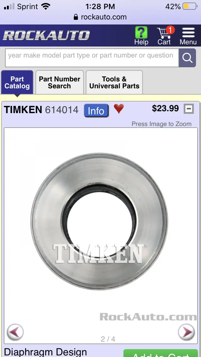

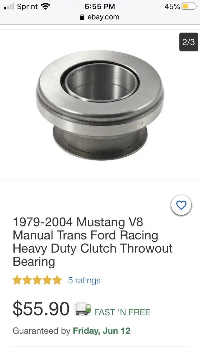

Those have the same “issue”. Can anyone confirm that’s how they are supposed to be?
It's normal for it to be off center. The face of it is allowed to move to center itself. You can actually move it back and forth from one side to the other with your hand.

The Timken bearing is a good one. The one in that clutch kit is garbage. I'm going to assume you have checked the retainer for any scarring or wear. I've had issues with worn bearing retainers causing all types of issues with throw out bearings. The last Ford Performance ones I installed have worked well. The one in my car was installed 4 or 5 years ago...I also installed one in a customers car about 3 years ago.

I recently had my clutch out along with the 20 year old ford racing TOB bearing. It does move slightly off center, it has to do to the way it slides down the input shaft. If you hold the bearing in your hand, you’ll find you can easily self cebter it. Might be harder on a new bearing vs one with some miles
