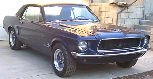

225/60-15 tires will be stock height and look pretty good. I have 225/60s on the front and 235/60s on the back. The rear end is a narrower '65 width which is why they tuck under the fenders like that.
