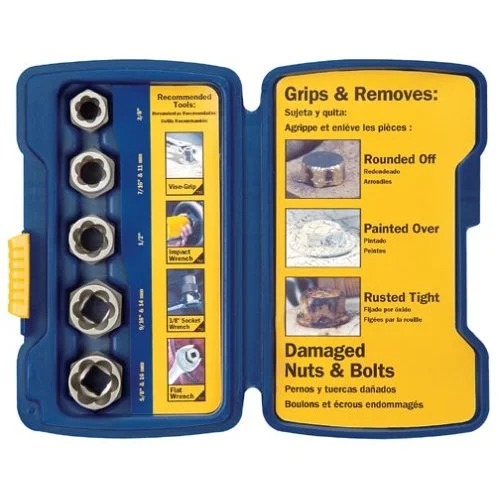

Yeah got the starter out, it was a pain though. The two top bolt heads were rounded off some but I've got the engine lifted up a few inches in a hoist so I was able to get at them with an irwin bolt grip remover and an impact wrench.
