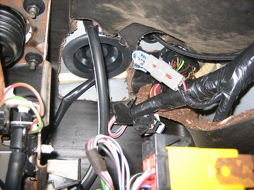

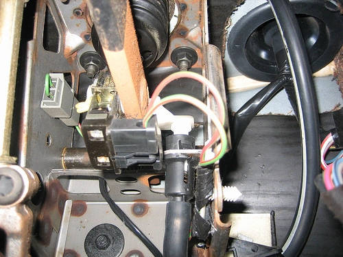

Here are the 2 side by side form my 95. Both uses an electrical connector on the booster rod

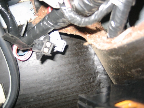

These two hook up the the switches on the drivers side of the assembly
Remove this jumper so it wont start without the clutch petal down
Autos use the green jumper and sticks you remove the jumper and put on that switch with the wire coming out of it
Don't forget you will need a t5 computer or a chip from a 5 speed
Yeah, thats what I need. I guess I have the wrong one. Well I looked through my paperwork and it was not MPS, it was Prestige Mustangs out of Georgia. I called them up and they are trying to figure out what to do about it. Thanks for the pic.
