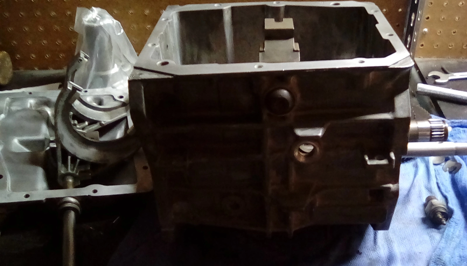

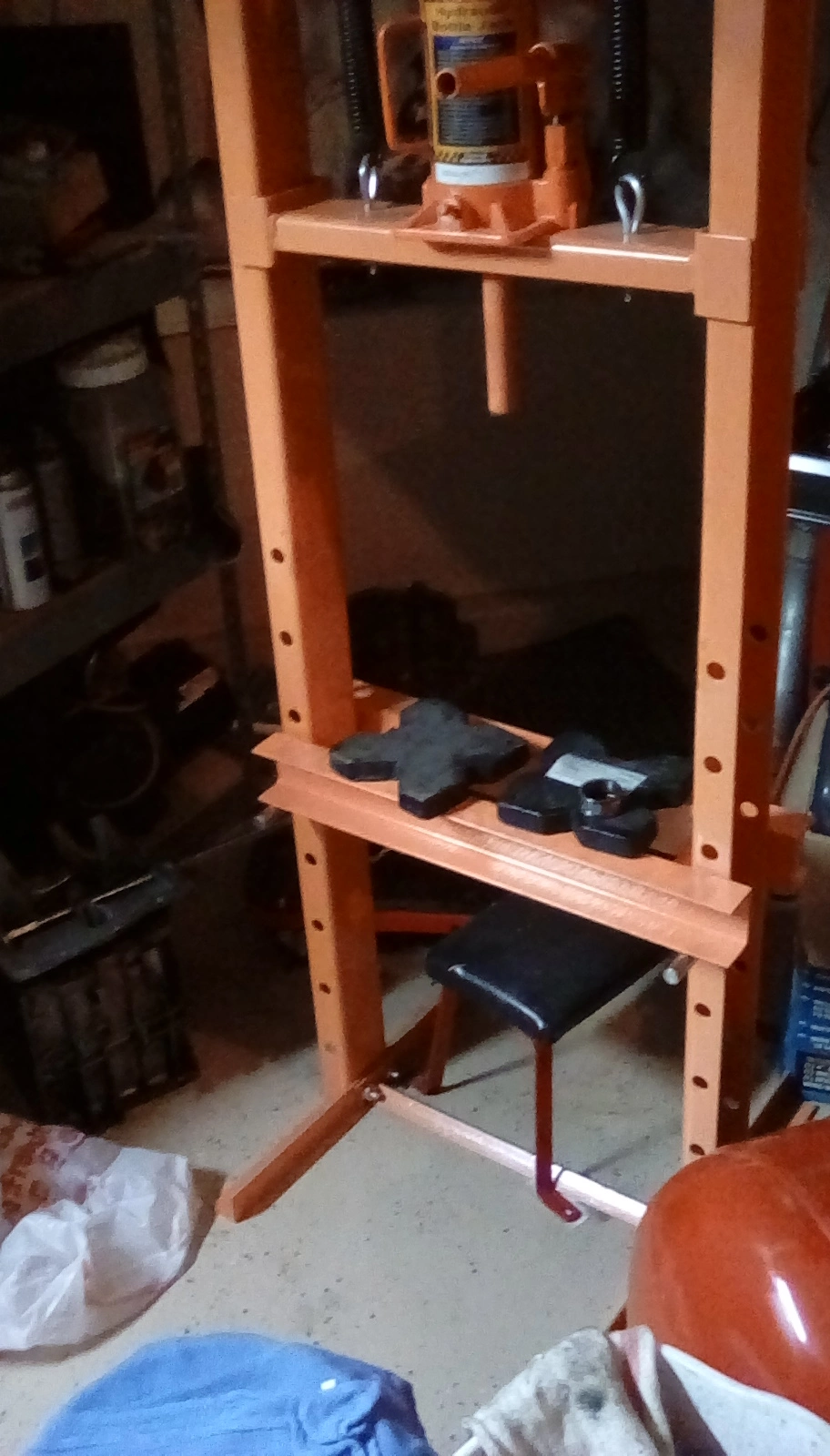

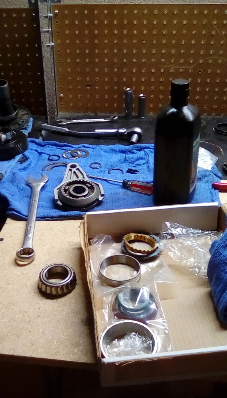

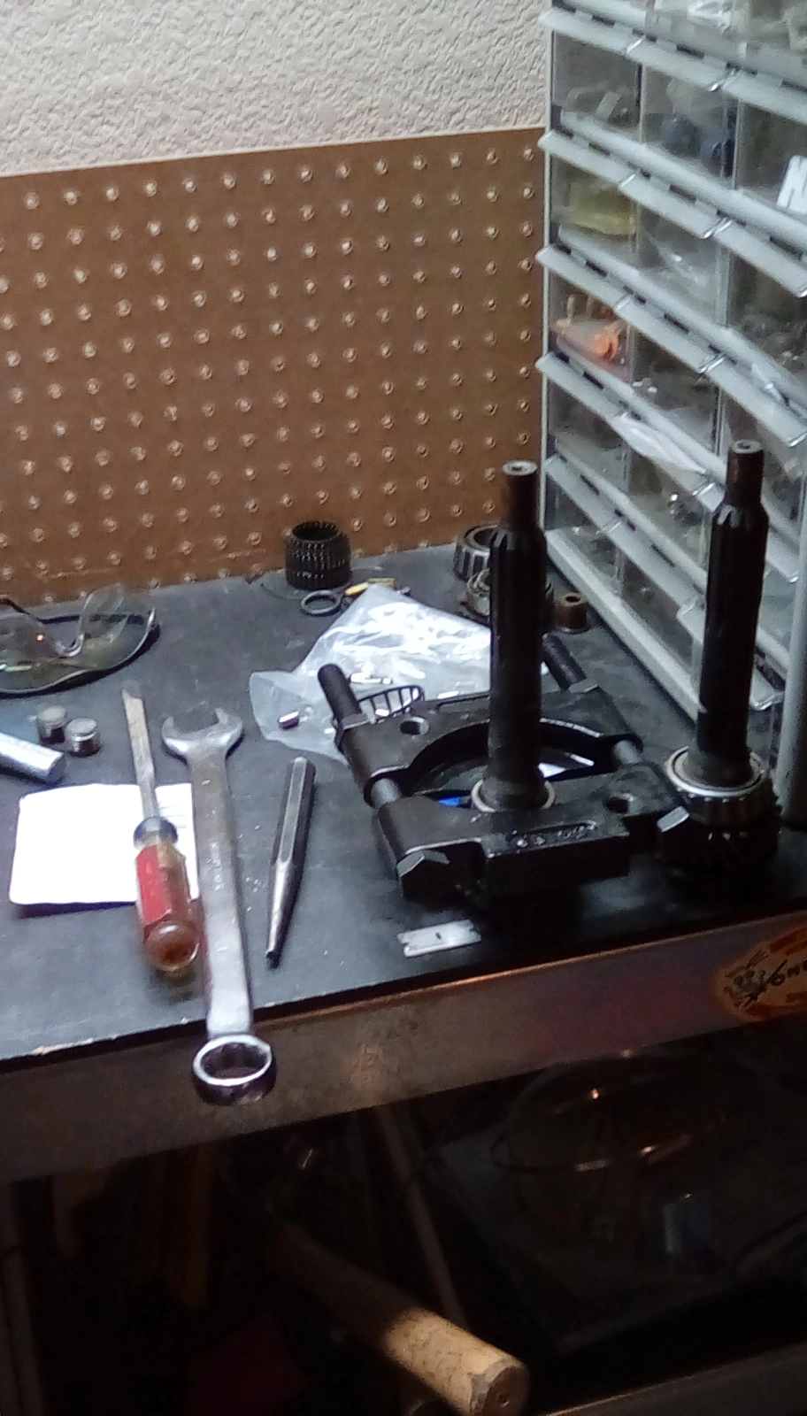

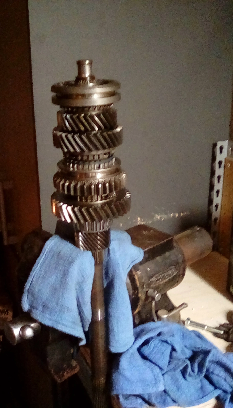

I agree.here some pics of trans in parts.,and my daily..
