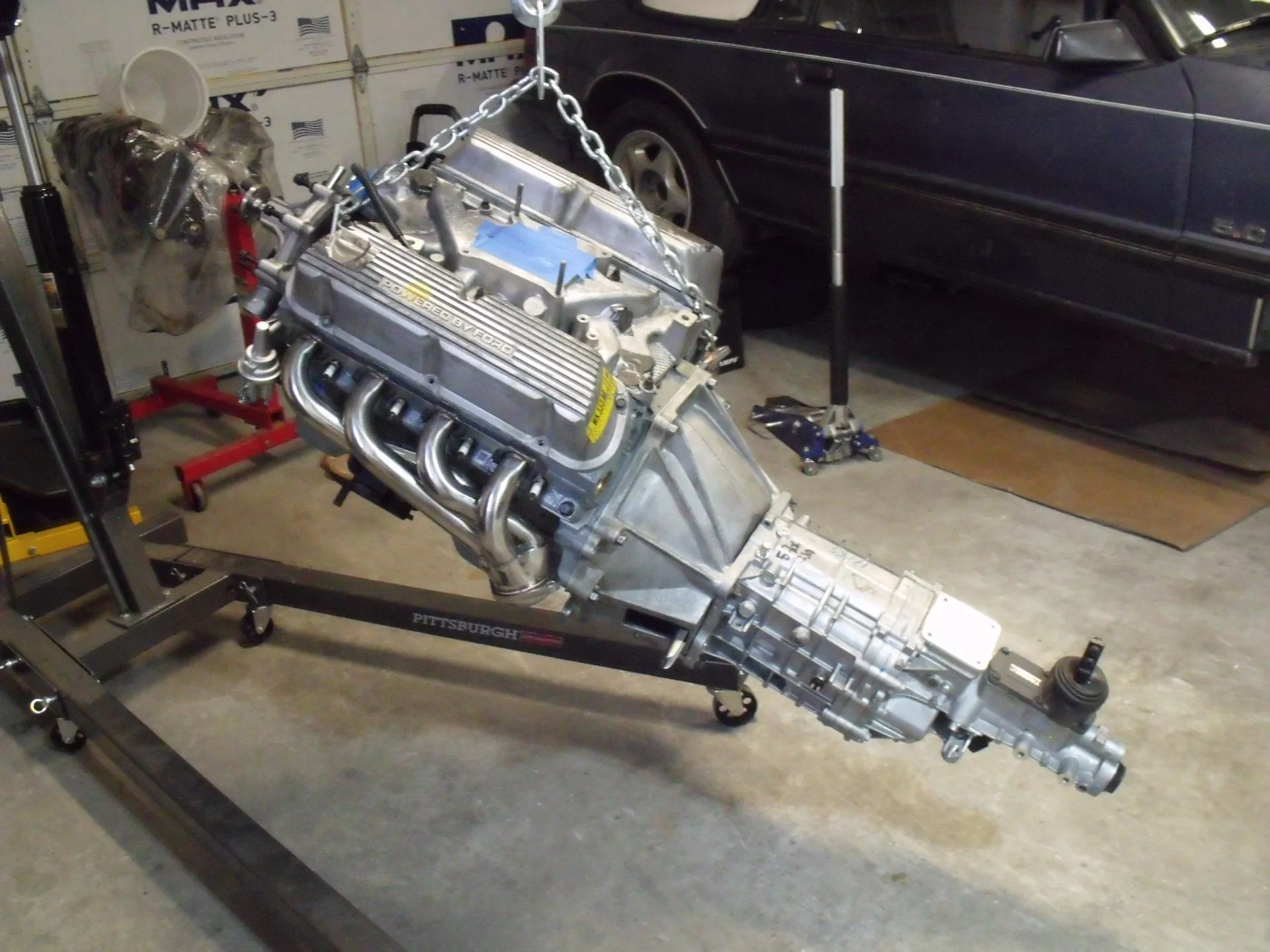

When I started on my project, ( its an 83, 302, SROD 4/speed car) I was going to do a LOW cost NO garage queen redo on the car....
Its NO garage queen but certainly saying its been LOW cost is not quite true.....
My SROD and my 7.5 inch rear end were in good shape but I only wanted to do this project once.....
I purchased the TKX for $2800 , and I am glad I went this direction instead of a T5.....
One reason I did the TKX vs T5 was the TKX bolted to my SROD bellhousing while I would have to buy a new bell to use a T5... And PUHLEEZE don't tell me about the $50 T5 bells around used.... NO SUCH thing....
The TKX is advertised to be twice as strong as the T5, so it has that going for it too, but was not a factor with my low horsepower car....

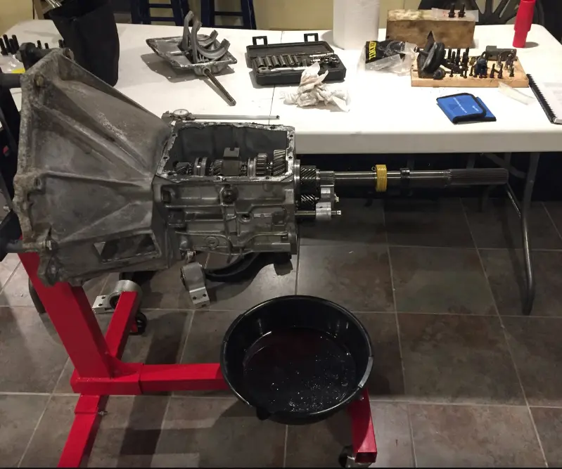

After doing some more research I’ve found pro motion power train. They’re who I bought my king cobra clutch their website says their labor for rebuilding is 400 plus parts and shipping. Has anyone sent their tranny to get rebuilt by them or know anything about them? I can’t find any bad reviews on them.
They did mine. Walt's been doing these for over 25 years. No shipping if you drop it off at their shop. It was $2k for all new Tremec internals & cryogenic treatment. Tremec no longer makes parts for the T5. It took about 10 weeks, waiting for parts & sending out of cryo. It's now rated for 400 hp, 400 lb-ft.

Would it be worth taking my old transmission and selling it? What could I get for something like that?
Values are all over the place, but there is value in the parts. All depends on what is good on it and what is not.
Case, tailhousing and lid have value. The mainshaft will prob fetch decent coin if the tip is not galled up. The individual forks and smaller rails and reverse specific parts probably have smaller value. If any of the gears are in great shape they also have value but if they are chewed up it's scrap.
There's a pretty good T5 specific FB group. "Tremec Borg Warner T5, t56, TKX, TKO" that can help you get a rough value and possibly offload parts locally.
