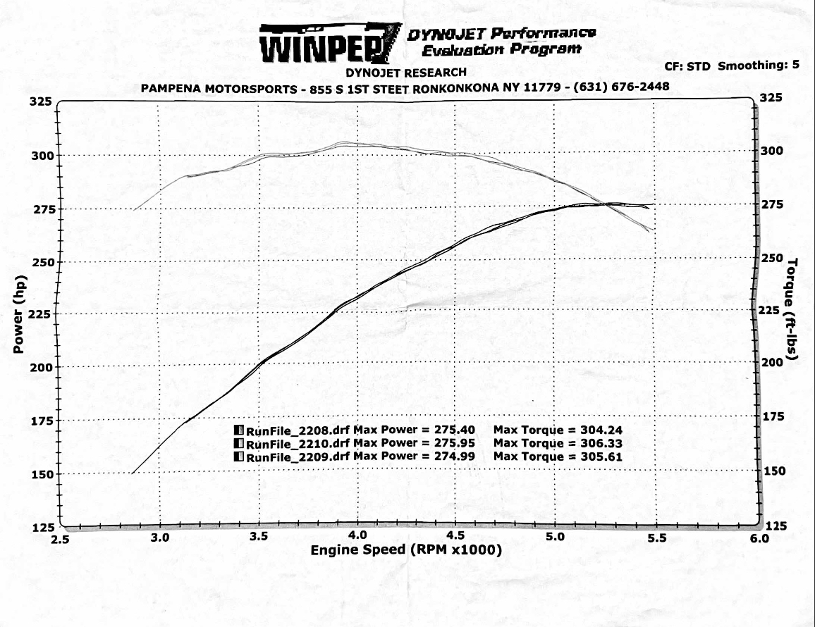

So this is the dyno graph my car had in the glovebox when I bought it. Accounting for 15% drivetrain loss that’s about 316 hp and 350 lbs ft of torque. I don’t run slicks, don’t take it to the strip, and rarely launch it. The car has 275/40 nitto nt555s in the rear. Just some fun spirited driving. Will that be an issue for the t5z?

Ok great that’s good to hear.
